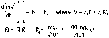

This will be a special coordinate system (0'X'Z') with the X'-axis parallel with the plane (and increasing "up the plane"). The unit vectors are then I' and K'. The free-body diagram shows this information. The momentum equation and its forces are written below:

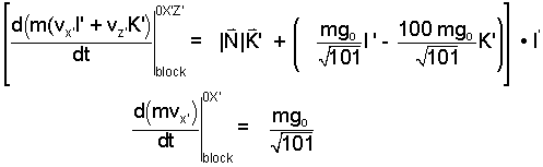

We proceed carefully by writing the normal and gravity force vectors in component form (above), then placing them in the momentum equation (second law) below. Motion involves the "up or down hill" the I' component. Hence we scalar multiply by the vector direction - I'. Recall that I' • I' = 1 and I' • K' = 0.
So here we are again. The above first order differential equation tells us the change of momentum of the block is a constant. Initially the velocity of the block is zero and we place the beginning of the coordinate space (0X'Z') to be the beginning position. The relevant space for the slide is 0X' and the - on the term right of equality means the block moves leftward, down the plane. Though Galileo had no calculus, he knew the velocity and position of the block to be.
Applying the numbers of his test into the equation (above right) we obtain:
The value we use is 9.81 m/s² So Galileo's answer was reasonably close.
