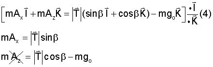

Next we write the acceleration in component form, remove "time-dependence" from the angle, β then scalar multiply the(3) by the unit vectors I, then K. Two scalar equations result to be solved:
Equation (4): [m A_x I + m A_z K = |T| (sin β I + cos β K) − m g_o K], scalar multiplied by I and by K (4): m A_x = |T| sin β; m A_z (struck out as zero) = |T| cos β − m g_o
(4) to "find" the number.
The "third" equation of Eqn-4, has Az = 0 because by observation the elevation of the BODY does not change. The BODY does not move in the "z" direction that component of its acceleration has magnitude, zero.
Equation (5): A_x = g_o sin β / cos β
(5) to "find" the number.
