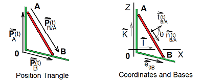

Vectors are used. Vector descriptions of a mechanism begin in general and are made more specific thereafter. The Position Triangle is our first step. We place the origin at the 105° angle. Just a general or "implicit" statement is needed to start. See the sketch, (below left). The Position Equation is written just below the sketch.
Two sketches of bar AB: the position triangle with P_A(t), P_B/A(t) and P_B(t); and coordinates and bases with X–Z axes, unit vectors I, K, bar unit vectors t_B/A and n_B/A, angle θ, and e_0B along the slope. Some beginning notations are needed.
Equation (1): P_A(t) + P_B/A(t) = P_B(t)
(1)
Position Triangle
The Position Equation reads as, "The position of "A" (which changes in time) plus the position of "B relative to A" (which changes in time) equals the position of "B" (which changes in time). Eqn-1 tells the geometry in a compact way. That the equation terms are vectors and time dependent; we know by the "over-arrow" of each term and the notation "(t)," respectively. The form of Eqn-1 is said to be "implicit."
To use Eqn-1 it must be written explicitly. This requires definition of coordinate references with unit vector bases. As you read below, refer to the sketch Coordinates and Bases.
1) We define a 2-D Cartesian reference attached to ground, origin at "0" with axes X and Z (this is an0XZ-space). Associated unit vectors are I and K.
2) Next imagine a pair of unit vectors scribed onto Bar-AB.
i) A normal unit vector, nB/A(t), on the line from A to B, points in the direction of B.
ii) A tangent unit vector, tB/A(t) perpendicular to the normal.
iii) An angle of rotation is added to defined positive angle, angle rate and angle acceleration.

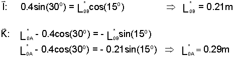

Separate Eqn-6 into its components.
Equation (7): I: 0.4 sin(30°) = L*_0B cos(15°) ⇒ L*_0B = 0.21 m. K: L*_0A − 0.4 cos(30°) = −L*_0B sin(15°); L*_0A − 0.4 cos(30°) = −0.21 sin(15°) ⇒ L*_0A = 0.29 m
(7)
Components of the specific position equation.
These are the "position" results for the specific time.

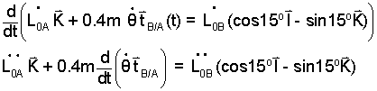

Acceleration Triangle: The derivative of a Velocity Equation, Eqn-13, yields an Acceleration Equation.
Equation (16): d/dt (L̇_0A K + 0.4 m θ̇ t_B/A(t) = L̇_0B (cos 15° I − sin 15° K)); L̈_0A K + 0.4 m d/dt (θ̇ t_B/A) = L̈_0B (cos 15° I − sin 15° K)
(16)
e016
The next equation displays the differentiation of the second term.
Equation (17): L̈_0A K + 0.4 m (dθ̇/dt) t_B/A + θ̇ (dt_B/A/dt) = L̈_0B (cos 15° I − sin 15° K)
(17)
