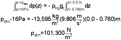

Next place these limits properly and integrate Eqn-4. The density of mercury and acceleration of gravity are entered. For this example, these numbers need to be precise.
Equation (4): ∫ from p = 16 Pa to p = p_atm of dp(z) = −ρ_Hg g_o ∫ from z = 0.760 m to z = 0.0 m of dz; p_atm − 16 Pa = −13,595 (kg/m³)(9.806 m/s²)(0.0 − 0.760) m; p_atm = 101,300 N/m²
(4)
