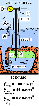

An image of an off-shore natural gas well is shown. In normal operation natural gas flows from a gas reservoir beneath the ocean floor upward through pipes to the production rig then through pipes leading to shore facilities. Occasionally valves are closed such that the gas flow is stopped. The "stopped or no-flow" condition is our interest.
The schematic sketch below right depicts the basic "stopped flow" configuration. Also some representative average densities of the substances involved are provided. Some reference points for our analysis have been added. Use the information provided to calculate the approximate reading of the pressure gage (G.R.) located at the well head, at location: "D."
i02
♦  The procedure we will apply is to identify a place where we know the pressure, then apply the hydrostatic principle (successively) to obtain an equation in which the G.R., the reading of the pressure gage at the wellhead, is the only unknown quantity.

Point D is in a location in atmospheric air immediately outside and at the same elevation as the gage. Now construct an equation containing the gage reading, GR. Begin at point A where the pressure is known to be one atmosphere.
patm = pA
(9) (9)
At B (in sea water) the pressure is greater than at A by the amount of pressure added by a column of sea water 2200 feet in height. The pressure in the gas also equals, pB
patm + ρsea water g (2200 ft) = pB
(10) (10)
The point C is directly above B. Pressure, starting at B will decrease steadily with positions above B. The pressure at C is:
patm + ρsea water g (2200 ft) - ρgas,avg g (2320 ft) = pC
(11) (11)
The point D is the ambient pressure outside of the gage. The gage reading tells us the difference in pressure, pinside- poutside. Thus if we subtract the gage reading (GR) from pC we get pD.
patm + ρsea water g (2200 ft) - ρgas,avg g (2320 ft) - GR = pD
(12) (12)

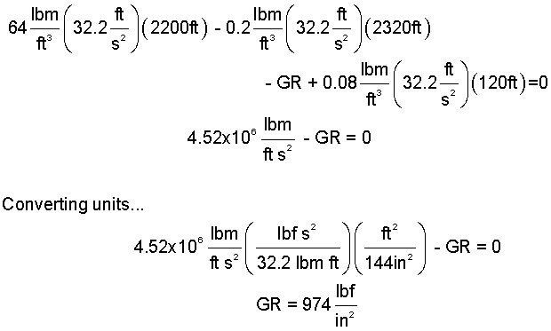

We see our equation has two unknown terms: pD and GR. Lets return to point A where the pressure is patm.
- ρgas,avg  g (2320 ft) - GR +  ρair g (120 ft) = patm
(13) (13)
Now we have one equation and one unknown. Subtract patm from both sides. Put numbers into the equation.
Off Shore Solution
