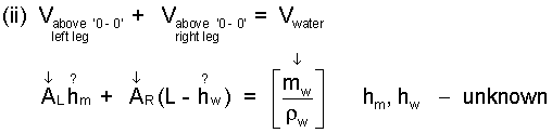

  2. Fluid Volume Above "0 - - 0": Initially in the U-tube, the mercury volume is unknown. But once the water is added some fluid will reside above the "0 - - 0" datum. Mercury on the left and water on the right.
    (ii) V_above 0–0, left leg + V_above 0–0, right leg = V_water; A_L h_m + A_R (L − h_w) = [m_w / ρ_w]; h_m, h_w unknown
