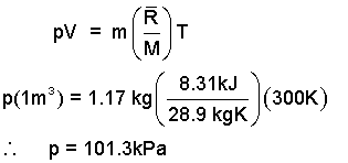

In usual applications the gas species is known, hence its molecular weight is known and the Gas Constant is a constant, of course. Thus given values for V, m and T, it is an easy matter to solve the above equation (as is) to determine the pressure of the gaseous state. For example:
Calculate the pressure of one kilogram of air at 300 K. The mass of the gas is 1.17 kilogram and it is contained in a space of volume one meter cubed.
♦ Air is a homogeneous mixture. (Air is the ONLY mixture addressed by basic thermodynamics. All other ideal gas substances are assumed to be pure substances.) The effective molecular weight of air, Mair, equals 28.9.
Equation (3): pV = m (R̄/M) T; p (1 m³) = 1.17 kg (8.31 kJ / (28.9 kg K))(300 K), ∴ p = 101.3 kPa
(3) This equation is clear. Learn to use it AS IS.
Algebraic manipulation brings no meaning;
it only scrambles the units.
So we apply the numbers to Eqn-1 as it is. The calculation is easy to do on the calculator and using the above units kJ, kg, K, and m3 we know the unit of the resulting pressure is kilo-Pascals. Develop the habit of leaving equations alone.

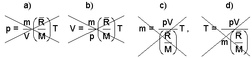

However, what happens as the first step is most students perform an algebraic manipulation to recast pV = m(R/M)T as equation a) below for solution for pressure or as b) or as c) or d) to solve for V, m , or T respectively.
Equation (4): Four rearranged forms of the gas equation, each crossed out: a) p = (m/V)(R̄/M) T; b) V = (m/p)(R̄/M) T; c) m = pV / ((R̄/M) T); d) T = pV / (m (R̄/M))
(4)The Ideal Gas equation does not need to be “re-arranged”. To re-arrange is a waste of time that scrambles the units making them harder to deal with. The mass, momentum, and energy equations are physical ~ they should not be “re-arranged”. Whoops, notice the algebra error I made c). Avoid useless algebra!
Resist the impulse to rearrange the equation, pV = m(R/M)T, according to the goal of algebra, "Get the unknown left of equality." The equations a) through d) contain no information not contained in the original form (notice one, some (?) are wrong!). Learn the proper units for the original arrangement then use it and them.
