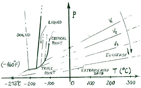

Further inspection of the data revealed lines of pressure versus temperature (on a constant volume path) to be straight. It appeared the lines, upon extension (to low temperatures unavailable then) would intersect the temperature axis. Most data indicate a temperature (by straight line extrapolation) at which gases would have "zero" pressure. The lines show a convergence Graph of pressure against temperature with the constant volume lines extended back (dashed) to meet at zero pressure at −273°C, −460°F. at some, new and very cold temperature.
At the times of these investigations, temperatures lower than 0°C (32°F) were difficult to produce in the laboratory.
So the scientists extrapolated the data to lower and lower temperatures (i.e., to the limit "zero pressure'). As close as they could determine, all paths of constant volume lead to a single crossing of the temperature axis. In terms of temperatures known then, the crossing temperature was very cold and negative. Careful numeric extrapolations indicated these temperatures to be -273°C (-460°F).

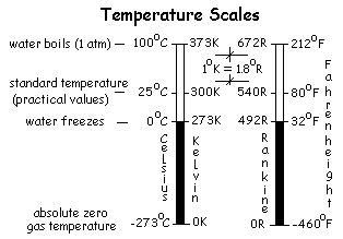

Thus, it was discovered that by changing the temperature scales (to have a new "zeros") all ideal gas data could be represented analytically in a much easier, logical "ideal gas equation" form. The two new "gas" temperature scales developed were the Rankine scale and the Kelvin scale. The principal use of these scales is for calculation of ideal gas behavior. For that reason these temperatures are called ideal gas temperatures (and, by some, absolute temperatures).
With the new temperature scales, it became possible to generalize the data of gases, to be called "ideal gas behavior." The state properties of an ideal gas (p, v, ρ and T) can be described Temperature scales compared, Celsius, Kelvin, Rankine and Fahrenheit: water boils (1 atm) at 100°C, 373 K, 672 R, 212°F; standard temperature (practical values) 25°C, 300 K, 540 R, 80°F; water freezes at 0°C, 273 K, 492 R, 32°F; absolute zero gas temperature −273°C, 0 K, 0 R, −460°F; 1 K = 1.8 R. by a single, analytic equation having a single constant of proportionality - the gas constant, designated by the symbol, R(capital letter, R with an over-line). Some authors call this the "Universal Gas Constant."

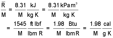

Values of the Universal Gas Constant in different units are:
Equation (4): R̄/M = (8.31/M) kJ/(kg K) = (8.31/M) kPa m³/(kg K) = (1545/M) ft lbf/(lbm R) = (1.98/M) Btu/(lbm R) = (1.98/M) cal/(g K)
(4)4
The gas constant is widely used in thermodynamic design. Thus, its value, in at least in one unit system, should be memorized.

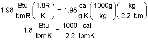

The Kelvin temperature scale has 100 degrees increments between the "freeze" temperature and the "boil" temperature of water. The Rankine scale has 180 degrees between the same water-standard temperatures. Thus 180 increments of Rankine degrees is equal to 100 increments of Kelvin degrees. We write this equivalence as: 1 = 1.8R / K. A kilogram equals 2.2 lbm. Make these conversions:
Equation (6): 1.98 Btu/(lbm R) (1.8 R/K) = 1.98 cal/(g K) (1000 g/kg)(kg/2.2 lbm); 1.8 Btu/(lbm K) = (1000/2.2) cal/(lbm K)
(6)6
And with a little algebra and rearrangement:
Equation (7): Btu = (1000 / (1.8 × 2.2)) cal = 252 cal

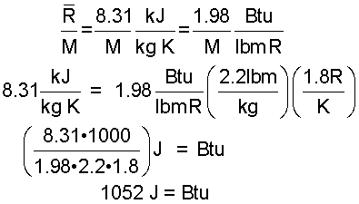

This conversion determines the number of Joules in a British thermal unit.
Equation (8): R̄/M = (8.31/M) kJ/(kg K) = (1.98/M) Btu/(lbm R); 8.31 kJ/(kg K) = 1.98 Btu/(lbm R) (2.2 lbm/kg)(1.8 R/K); (8.31 • 1000 / (1.98 • 2.2 • 1.8)) J = Btu; 1052 J = Btu
(8)8
If you are on a date and things are boring, use the gas constant to determine the number of calories in a Joule.
Modern engineering equipment has managed to create and sustain very cold temperatures for the further study of ideal gases at lower temperatures. It was anticipated and discovered that as gases became colder (at constant pressure) they adapt but then at some temperature, each changes to its liquid phase. Then the liquid, being further cooled to still lower temperatures - ultimately adjusts by phase change to its solid phase. The graphic below depicts how the lines of "perfect gas behavior (first figure above)" change as all substances cease to be ideal gases at low temperatures. The right side of the figure is a phase diagram for a gas. The phase diagram for water is a topic of Chapter 4.
Hand-drawn pressure–temperature graph: constant volume gas lines for V₁, V₂, V₃ (volume increasing) with extrapolated data converging toward −273°C (−460°F); the solid and liquid regions, triple point and critical point are marked at lower temperatures.
