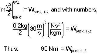

♦ The puck moving horizontally on ice has constant potential energy. The energy of the "shot" becomes increased kinetic energy of the puck. The extrinsic energy equation has two terms, ΔKE and the work. We calculate the kinetic energy change. Ignoring losses to a "sloppy" slap shot, splintering of the stick... we obtain the LEAST work.
Equation (1): m v₂²/2 (puck, 0XZ) = W_puck,1-2, and with numbers, (0.2 kg/2)(30 m/s)² (N s²/kg m) = W_puck,1-2. Thus: 90 Nm = W_puck,1-2

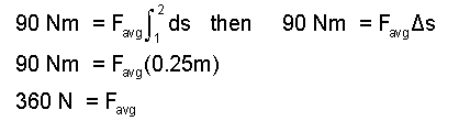

Our resulting integral requires specification of how the force magnitude |F(s)|, varies in magnitude along the path of its application denoted by the length s (initially zero and finally 25 centimeters). This we do not know. So we apply the mean value theorem (MVT) to retrieve the average force.
Equation (5): 90 Nm = F_avg ∫ from 1 to 2 of ds, then 90 Nm = F_avg Δs; 90 Nm = F_avg (0.25 m); 360 N = F_avg
(5) 5
It is often in analysis that you will encounter an integral with a "stubborn" integrand. Whenever this happens, we "give it a slap" by using the Mean Value Theorem of calculus.
