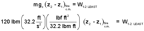

The change of potential energy of Earth is zero. The potential energy change of the tire is proportional to the change of elevation of its center of mass. Calculation of the least work is as follows:
The boys, being small, lifted the tire slowly from the shop floor such that it never attained any kinetic energy while being lifted and tipped against the wall. So kinetic energies of the tire are zero. Whatever (the least) energy change as work by the boys to the tire equals the increase of potential energy of the tire. Mass times its change of elevation of its center of mass position, we can calculate its change of energy. Let's go that way.

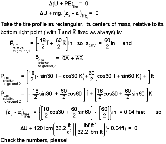

b) The boys roll the tire next to a wall. Calculate the work. This requires work but not much if the boys work together. Boys fight sometimes. Who knows?
Clean Tip Tire
c) With the tire beside the wall, the boys let it fall from vertical to impact and rest against the wall (as shown). Assume the wall is perfectly rigid. Calculate the increase of internal energy of the tire.
Clean Garage Eqn 3
(5) 5
