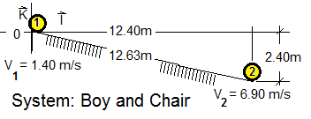

A boy in a wheelchair of mass 45kg (boy at 35kg) has a speed of 1.40m/s at the crest of a slope having a run of 12.4 meters and a rise of -2.40 meters. The boy and chair roll down the slope, arriving at the bottom with a speed of 6.90m/s. The average friction force is 41N. Calculate the work the boy did pushing on his wheels during the downhill ride.

♦ System: A system must be selected. Taken individually we might choose the "boy," or the "chair." Or we might choose to analyze the "boy and chair" taken together. As a rule, the larger, more encompassing system one might use turns out to be easiest to solve. Thus, as system, we select: boy and chair."
Kidchair Geometry ♦ Sketch: A sketch showing dimensions and the event information is helpful. Our coordinate space will be "0XZ."

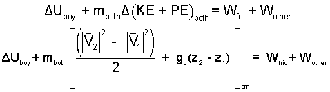

♦ About Heat: In basic thermodynamics heat is either: i) "given", ii) the unknown sought, or iii) heat is zero. We assume prior to commencement of the roll-down event that the system was in thermal equilibrium. Heat requires temperature difference and time. Although al­tered temperatures might happen in roll-down, we assume there to be insufficient time for heat. Hence we set ΣQ = 0 in Eqn-3, below.
Eqn-3 presents the energy components as increments: internal, kinetic and potential. Also the work is divided into that of friction (drag) and "other."

Procede left to right with Eqn-3. Write the internal energy change of the boy first, separately. Next, the specific kinetic energies and potential energy of the boy equals that of the chair so group and subscript as "both." Internal energy of the chair might change with a change of its of temperature or volume but neither change happens: the chair internal energy is constant. Eqn-4.

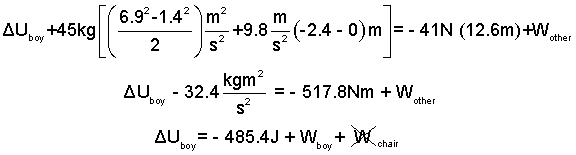

It makes sense to insert some of the numbers we are confidant about. These steps are shown as Eqn-5. In the result of Eqn-5, work of the chair is struck out. The chair is simple compressible, dW = -pdV. For the event there is no dV.

This final equation form has internal energy change of the boy left of equality. This might be about zero provided the boy is motionless. However, if ΔUboy is zero then Wboy is positive meaning energy as work entered the boy. This is complicated as are most systems having a living component.
