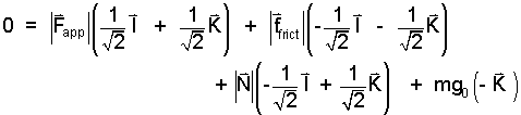

Next write the forces in magnitude-direction form. The unit vector directions of the forces are parallel or perpendicular to the incline.
Equation (3): 0 = |F_app| ((1/√2) I + (1/√2) K) + |f_frict| (−(1/√2) I − (1/√2) K) + |N| (−(1/√2) I + (1/√2) K) + m g_o (−K)
(3) 3
Vector algebra is required. One procedure would be to collect all of the terms having the unit direction, I and the others having the unit direction, K. The vector with these components equals zero, so the magnitudes of the components themselves must equal zero.

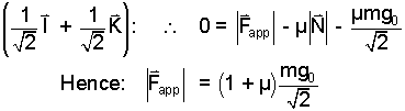

The "parallel to the slope" unit vector and its multiplication of the above equation are:
Equation (5): Scalar multiplying by ((1/√2) I + (1/√2) K): ∴ 0 = |F_app| − μ|N| − μ m g_o/√2. Hence: |F_app| = (1 + μ) m g_o/√2

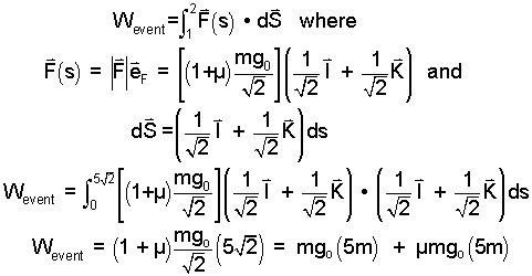

The work is the integral of the applied force through its displacement.
Equation (6): W_event = ∫ from 1 to 2 of F(s) • dS, where F(s) = |F| e_F = [(1 + μ) m g_o/√2]((1/√2) I + (1/√2) K) and dS = ((1/√2) I + (1/√2) K) ds; W_event = ∫ from 0 to 5√2 of [(1 + μ) m g_o/√2]((1/√2) I + (1/√2) K) • ((1/√2) I + (1/√2) K) ds; W_event = (1 + μ)(m g_o/√2)(5√2) = m g_o (5 m) + μ m g_o (5 m)
(6)6
The result above shows work of the applied force identified as two components. The applied force did work to elevate the crate and also to overcome friction.

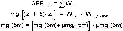

Equation (7): ΔPE_crate = ΣW₁₋₂; m g_o [(z₁ + 5) − z₁] = W₁₋₂ − W₁₋₂,friction; m g_o (5 m) = [m g_o (5 m) + μ m g_o (5 m)] − μ m g_o (5 m)
(7)7
Thus we see a strict accounting of energy for pushing the crate uphill shows a work effect that is in excess of the energy change of the system. It is tempting to update the Mechanical (or Extrinsic) Energy Equation to include friction as:
Equation (8): ΔPE_crate = W₁₋₂ − W_friction,1-2
(8)8
That creates complications. Where does the energy transfer of friction work come from or go? The energy equation applies to the system. For movement of the block, all of the energy of friction "came from" the agent that pushed the block. The energy of the block increased by the work; temporarily the block temperature increased. But upon arriving "uphill" the block will have passed that energy ro the surface of the inclined plane and surrounding atmosphere. Some call the work, "lost work." Others call it "irreversible work." Friction is difficult to analyze in a general way. Thermodynamics texts generally avoid friction by studying only "quasi-static" processes.
