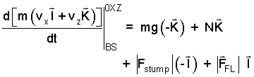

The system model we will use is "extended body." The system free-body-diagram (below right) shows four forces, all directed through the center of mass of the system. The momentum equation with the section as system is written below left.
Elevation free-body diagram of the barrier section in X–Z axes: fork lift force F_FL,x pushing right, stump force F_stump pushing left, gravity F_g through the center of mass and normal force N.
Equation (2): d[m (v_x I + v_z K)]/dt (BS, 0XZ) = mg (−K) + N K + |F_stump| (−I) + |F_FL| I
(2) 2
Neither the force of the stump, Fstump, nor the horizontal pushing force of the forklift, FFL, has a force component in the upward or K direction. Thus the gravity force and normal force of support by the roadway are equal and constant. The vertical component of the sum of forces being zero means that left-of-equality, d(m v z)/dt = 0.

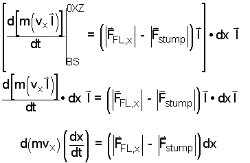

When the stump fails, motion will ensue. But before that, let's take a line or two to alter the momentum equation. Our task is to set it by vector multiplication to be applicable to a scalar, differential (x-direction) displacement.
Equation (4): [d[m (v_x I)]/dt (BS, 0XZ) = (|F_FL,x| − |F_stump|) I] • dx I; d[m (v_x I)]/dt • dx I = (|F_FL,x| − |F_stump|) I • dx I; d(mv_x)(dx/dt) = (|F_FL,x| − |F_stump|) dx
(4) ♦ The entire vector differential equation is scalar multiplied
an x-component, vector differential displacement.
♦ The multiplication is applied to the terms individually.
♦ In each term “I dot I” equals 1.
♦ A scalar differential equation results.
The time in our discussion is still "prior to event," t < 0+ . The right side of the above equation is zero, therefore so also is the left side. Nothing is happening! But the force applied by the forklift is increasing. When that force exceeds the capacity of the stump to resist, (at the time, t = 0+), the stump shears (assume instantly) whereupon the stump force, |F| stump, becomes zero. But |F| FL,x is at a "powered-up" (not zero) value, the event initiates, the BS moves.

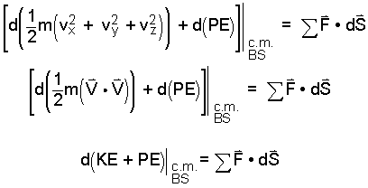

Equation (21): [d(½ m (v_x² + v_y² + v_z²)) + d(PE)] (c.m. BS) = ΣF • dS; [d(½ m (V • V)) + d(PE)] (c.m. BS) = ΣF • dS; d(KE + PE) (c.m. BS) = ΣF • dS
(21) 21
