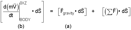

Below (for a BODY as system) analytic steps are shown (Newton's Second Law is altered) to represent the event of action of a single force (acting against a BODY) to represent its displacement , is transformed into the simplest energy equation, which we will call the mechanical energy equation. The derivation produces three important ideas and their mathematical forms. These are: Kinetic Energy and Work; then Potential Energy. It will suffice for us to consider 0XZ-space. A bare minimum of forces is needed for this discussion. These are the force of gravity and the sum of all surface forces which is subscripted "app" for applied.
32 Eqn 1
(1) 1
When this equation is scalar multiplied by an arbitrary differential displacement a scalar equation results in which the three terms above are transformed into differential kinetic energy, differential gravity work and differential work respectively. Below, we will complete theser mathematical operations step by step and as clearly as possible. To indicate scalar multiplication of the above equation by a differential displacement, we append " • dS " to each term.

We see we have changed the form of the first, vector of (2), d(mV)/dt. Now we write the vector differential displacement of the mass, dS.
32 Eqn 8
(8) 8
There are two equations immediately above. We set the scalar product of the terms "left of equality" equal to the scalar product of the terms "right of equality." We leave "left of equality" implicit and complete the product "right of equality."

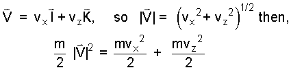

The above operations have shown (2) to be equivalent to the intermediary result (A). To proceed we write the vector V in component form, obtain its magnitude, |V|, square that magnitude and multiply it by m/2..to have m|V|2/2.
32 Eqn 10
(10) Check these steps. The result is correct but the steps are compact.
The term, m|V|2/2 , is called the kinetic energy of the BODY. When we take the derivative of the kinetic energy we discover that it equals the terms above, (A).

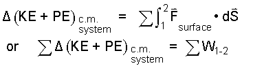

The term right of equality is stubborn and has not been reduced to some general scalar differential form. Some texts label the term "differential work" and write it as dW with a horizontal dash through the top of the d, a strike-through. Something like: dW. The term constitutes invention of a new differential that is inexact.
An immediate uses of this equation is to associated it to a specific system/event then integrate it between appropriate limits. Terms "left of equality" integrate readily to become increments. The work term is integrated symbolically:
32 Eqn 16
(16) 16

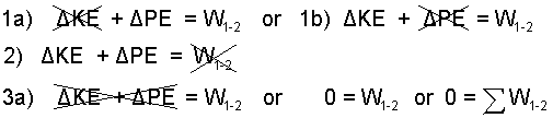

As you learn, you will become able to test the value of any equation without putting it to a specific task. There are no general rules or steps. Above is an equation. Lets think of physical possibilities, some ideas, the equation purports to explain. To start, lets drop the summations. Whatever works in summation must work for one.
32 Eqn 17
(17) 17
The above equation encompasses a variety of events of a body.
Conditions
Zero Initial and Final Speed
Recognizing that W means ΣW, another event equation is:
The equation above the table extends to , as it is, ???
The number zero, 0, means, "does not apply or has no value." Some possible applications of zeros in the equation are:
32 Eqn 18
(18) 18
Option 1 is logical.??? (typo) and mean, respectively, the initial and final speeds are equal or zero and the initial and final elevations the same. For mass or gravity to be zero is ridiculous. Option 2 asserts simply that energy of a system can change from KE to PE and the reverse. And since system mass is a factor of both terms, mass is neutral to such events. Option 3 reveals a weakness in notation of the original equation. We have a system. Hence left-of-equality being zero is legitimate and seems to say "there is no work." When in fact it says there is no net work. Had we used the summation sign, we would be discussing, 0 = ΣW1-2 which makes matters crystal clear. This last chat (and others like it) are avoided by carry the "Σ," the effect of which is to do the summing in the equation, not elsewhere.
