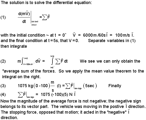

The solution is to solve the differential equation: (1) d(mV)/dt (car and driver) = ΣF, with the initial condition at t = 0+, V = 6000 m/60 s I = 100 m/s I, and the final condition at t = 5 s, that V = 0. Separate variables in (1), then integrate: (2) m ∫ from V = 100 m/s I to V = 0 of dV = ∫ from t = 0+ to t = 5 s of ΣF dt. We can only obtain the average sum of the forces, so we apply the mean value theorem to the integral on the right: (3) 1075 kg (0 − 100)(m/s)(I) = ΣF_average (5 sec). Finally (4) ΣF_average = 1075 (−100)(5) N I. The magnitude of the average force is not negative; the negative sign belongs to its vector part. The vehicle was moving in the positive I direction; the stopping force opposed that motion and acted in the negative I direction.
