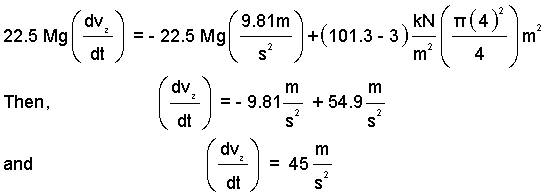

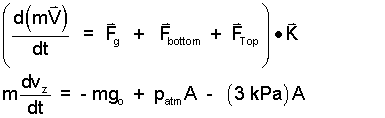

♦  With the rocket as system, we apply Newton's Second Law of Motion, in the vertical direction. Once the bottom is removed, atmospheric pressure will act across the bottom area and 3 kPa will act over its top. If the acceleration at that instant is positive or upward, the rocket will move upward.
Eqn 1
(1)
Newton's 2nd Law ~ vertical component.
We have numbers for most of the terms:
Eqn 2
(2)
Enter known numbers!
Thus upon "fire" (at t = 0+) the rocket will have an upward with an acceleration of 45 m/s².

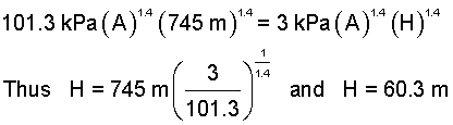

Ideal Gas states of a frictionless-adiabatic process obey the equation, pVγ = constant, where γ, the ratio of specific heats of air equals 1.4 . When the rocket attains the "deploy cover" elevation, the pressure of the air above it will have attained 101.3 kPa. That elevation, H of the second state (2), is calculated, below:
Eqn 3
(3) 3
Entering numbers into Eqn(3) (right-most expression), we obtain H, as:
Eqn 4
(4)4
Cent Mass Rocket Air Subject to our approximations, when the top of the rocket is 60.3 meters below the exit plane of the top cover, the trapped-air pressure will be 101.3kPa, and the top cover will deploy. At that time the air pressure above and below the rocket will be atmospheric.

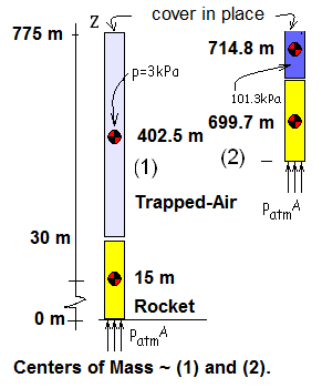

Potential energies of the event are important. The sketch, Centers of Mass, shows the initial, (1), and final, (2), elevations of the center of mass of the rocket (modeled as a solid) and the center of mass of the trapped-air (modeled as an ideal gas).
Our event involves action of both the rocket and the trapped-air. Analysis might proceed with a two system approach. To write and solve two energy equations; one with rocket as system, the other with as trapped-air as system. Alternately a combined system, one energy equation with both masses as system might be solved.

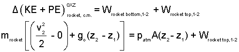

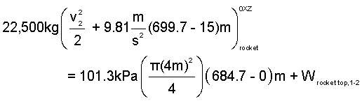

Energy Equation Rocket:  Modeled as a constant temperature solid with zero-heat for the event. Work of the event occurs via atmospheric pressure at the rocket bottom and via pressure of the trapped-air at its top.
Eqn 55
(5)5
Inserting known numbers:
Eqn 56
(6)6

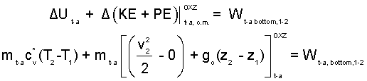

Energy Equation Trapped-Air:  Modeled as an Ideal Gas having a frictionless, adiabatic event (zero-heat). Work of the trapped-air occurs at the bottom of the trapped-air column.
Eqn 66
(7)7

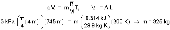

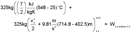

Appendix Calculations: The mass of trapped-air is 325kg, the specific heat of air as 7R/2M, and the temperature of the trapped-air, once compressed to 101.3kPa in a frictionless-adiabatic process, is 548°C. The "trapped-air" energy equation is Eqn-8.
Eqn 67
(8)8
Next, to have equations less cluttered, we "tidy-up" the terms of Eqn-6 and Eqn-8.
Eqn 69a
(9a)9a
Eqn 69b
(9b)9b

The sketch above, "Centers of Mass" shows states (1) and (2) of the system: rocket and trapped-air. The increment form of the energy equation for these two masses as system is:

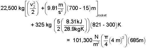

As the rocket moves up the shaft, because the air above the rocket is part of the system, there is only one work effect - the pressure of atmospheric air acting over bottom area the rocket as it displaces upward. The event ends when the top of the rocket is 60 meters below the exit. We set up the work integral carefully and write the energy changes explicitly.
Eqn 7
(7) 7

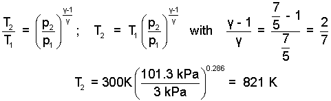

The temperature difference of the air can be determined. We assumed its process adiabatic and frictionless. In a previous example (Air Pistol) the following expression for the second temperature which uses the property, γ = 7/5 (for an ideal diatomic gas) was derived. . We combine these facts to calculate the second temperature of the gas.
Eqn 8
(8) 8
In addition, the mass of the trapped air is needed.
Eqn 9
(9) 9
The numbers are entered into the equation.
Eqn 10
(10) 10
Applying the numbers carefully:
Eqn 11
(11) 11
Watch the units!
Eqn 12
(12) 12

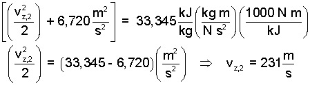

That seems a rather substantial speed.. Check the numbers, please. But then this is idealized.

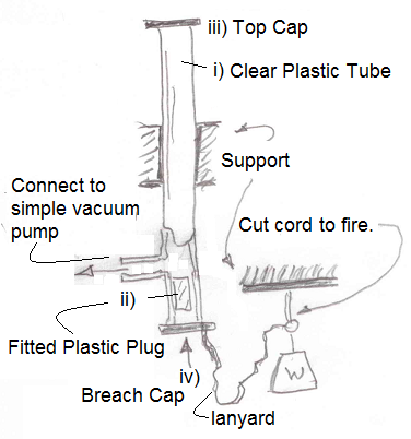

The basic idea of the launching system adapts well to become a HS demonstration. Figure shows the setup.
Plans
  1. Tube: A precision, clear glass tube works well. (say 2" ID by 40" L). Order one from a scientific supplier.
  2. Plug: A solid plastic plug is turned to fit the tube.
  3. Top Cap: Light rigid plate (aluminum).
  4. Breach Cap: I used a stretched, banded to cover aluminum foil (to be punctured).
  5. Port: A tube connects the tube to a simple vacuum pump. Include a pressure gage in the port tube.
