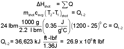

The internal energy of a solid shot is increased by the heat it receives from the very hot coal fire. From basic physics, the increase of internal energy of the shot equals the product of its mass times its specific heat times the degrees of temperature increase. Calculate the heat delivered to the shot of mass 24 pounds. An average specific heat (determined experimentally) for iron is: 0.35 (Joules/gram °C).
ΔH_shot = ΣQ; m_shot c_avg (T₂ − T₁)_shot = Q₁₋₂; 24 lbm (1000 g/2.2 lbm)(0.35 J/(g °C))(1200 − 25)°C = Q₁₋₂; Q₁₋₂ = 36,623 kJ (ft-lbf/1.36 J) = 26.9 × 10⁶ ft lbf
From "Point Blank," the kinetic energy was calculated to be 93,242 ft-lbf. The energy of a hot shot is more than 250 times greater. The intention in firing the hot shot is to set the enemy ship afire.
