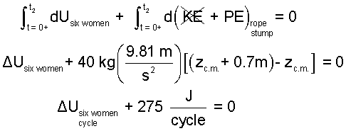

Let two times within each cycle be defined. At the time, t = 0+, the stump is on the ground with zero velocity, but at that instant the ropes are taught and the stump is about to be lifted by the women. The second time, t = 3 seconds is when the stump attains the top height of its lift. In this highest position instantaneous velocity is zero. It is between these times that the effort of the women occurs. Note the women provide effort, not work. With the cycle defined this way, the kinetic energy of the stump will be zero initially and finally; over this part of the event cycle. Thus using our approximated height, for one cycle of compaction:
Equation (4): ∫ from t = 0+ to t₂ of dU_six women + ∫ from t = 0+ to t₂ of d(KE (struck out) + PE)_rope,stump = 0; ΔU_six women + 40 kg (9.81 m/s²)[(z_c.m. + 0.7 m) − z_c.m.] = 0; ΔU_six women per cycle + 275 J/cycle = 0
(4)4

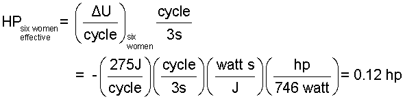

The power that makes the compacter operate is the physiological effort of the women. The energy rate can be approximated as:
Equation (5): HP_six women,effective = (ΔU/cycle)_six women (cycle/3 s) = −(275 J/cycle)(cycle/3 s)(watt s/J)(hp/746 watt) = 0.12 hp
(5)5

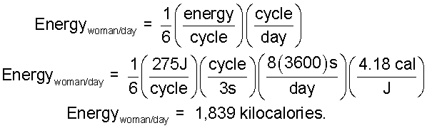

"Work to Food Ratio" With regard to rations, suppose 1,000 kilo-calories of food per day was supplied. Each physical body required about 700 kilo-calories to sustain health and life leaving 300 kilocalories for strenuous work. The women worked eight-hour days.
Equation (6): Energy_woman/day = (1/6)(energy/cycle)(cycle/day); Energy_woman/day = (1/6)(275 J/cycle)(cycle/3 s)(8 (3600) s/day)(4.18 cal/J); Energy_woman/day = 1,839 kilocalories.
(6)A calorie “thermal measure” equals one kilocalorie “nutritional measure.”
Thus insufficient nutritional energy is provided for this strenuous "work effort" to sustain itself.
