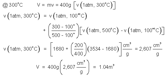

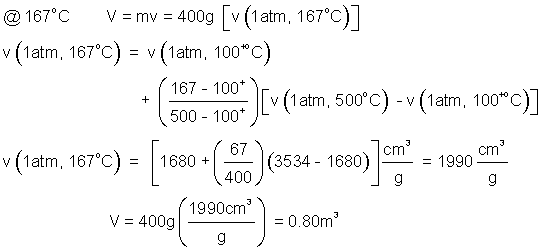

3) Determine the volume of 400grams of steam at 1.0 atmosphere and a) 300°C. b) 167°C.
♦  300°C is a nice number because it is midway between the table entries, 100+°C and 500°C. The fast answer is V = m{[v(500°C) + v(100+°C]/2}. Below we show all steps of the interpolation.
