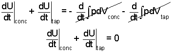

To solve this, some argue that the volume changes of the "work" terms of the concentrate and tap water are very small, whereupon:
05
(5)
(5)
But our event occurs at the constant pressure. This permits us to reduce the compression work terms as follows:
(6)
(6)
Combining the "∫pdv" result from Eqn-6 with the dU/dt's of Eqn-4, we obtain:
Ccc 07
(7)
(4-yes)
Next, using the definition, H = U + pV, our energy equation becomes (8a). We also write our mass equation as (8b):

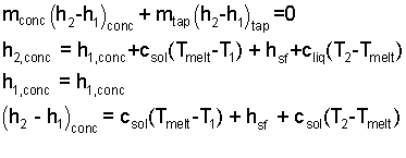

The procedure to change the rate form to the increment form follows steps (i) through (iv) (below).
Ccc 09
(9)(4-yes)
The initial state of orange juice is a mix of "one can" of concentrate, with "3 cans" of tap water. The mass equation states simply that the mass of the system finally will equal the mass of the concentrate and water. Initially the concentrate is at -15°C and the three volumes of water are initially 20°C.
Ccc 10
(10)(4-yes)
Ccc 11
(11)(4-yes)
Ccc 12
(12)(4-yes)
The water, finally, will have one temperature at one atmosphere of pressure. That temperature is unknown. The condition of phases is also not known. It might be all solid, at some temperature above 0°C, solid and liquid at 0°C or all liquid at some temperature. The subscripts of the mass equation (Eqn-3 - left-most term) indicate these possibilities.
One might wonder how large is the can, does the can size matter? The mass of a "can" of solid concentrate is essentially the same as the mass of that "can" filled with water. (The density of water as solid (ice) is about 4% less than as liquid). For this event the difference in liquid water mass per volume of can from solid mass per volume is insignificant. So much for the mass equation.
When the concentrate and water come together the process they experience is called thermal equilibration. The basic idea is tinitially temperatures are different throughout the water and as time passes a single, uniform temperature is attained all occurring at one atmosphere.
To write the energy equation we will identify three masses. The mass of ice as "icemelt" which melts. Then "icesolid" being that ice at -15°C that is warmed to 0°C but that remains solid and the water that is liquid at room temperature and is cooled to 0°C.
