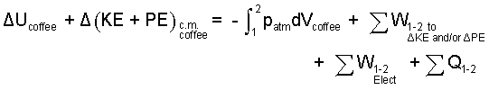

♦ This is an increment-type event. The energy equation is written as:
Equation (1): ΔU_coffee + Δ(KE + PE) (c.m. coffee) = −∫ from 1 to 2 of p_atm dV_coffee + ΣW₁₋₂ (to ΔKE and/or ΔPE) + ΣW₁₋₂,Elect + ΣQ₁₋₂
(1) 1
There will be no change of kinetic or potential energy of the liquid coffee. (nor work associated with such), (X).

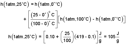

The above form is suited for retrieval of data from a table. We proceed to Table 4.2.2. The advantage of tabular data is accuracy. The disadvantage is that the information is discrete and interpolation is required. The interpolations are done below. The values entered into the equation.
Equation (5): h(1 atm, 25°C) = h(1 atm, 0⁺°C) + [(25 − 0⁺)°C/(100 − 0)°C][h(1 atm, 100°C) − h(1 atm, 0⁺°C)]; h(1 atm, 25°C) = [0.10 + (25/100)(419 − 0.1)] J/g = 105 J/g
(5) 5

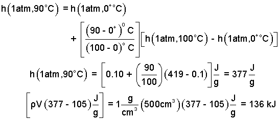

One more interpolation yields:
Equation (6): h(1 atm, 90°C) = h(1 atm, 0⁺°C) + [(90 − 0⁺)°C/(100 − 0)°C][h(1 atm, 100°C) − h(1 atm, 0⁺°C)]; h(1 atm, 90°C) = [0.10 + (90/100)(419 − 0.1)] J/g = 377 J/g; [ρV (377 − 105) J/g] = 1 (g/cm³)(500 cm³)(377 − 105) J/g = 136 kJ
(6) 6

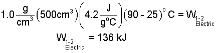

To use an average specific heat approach, we restate the above as:
Equation (7): [ρV c (T₂ − T₁)]_coffee = W₁₋₂,Electric
(7) 7
The sketch, above right, shows the path of change of the water in state space. Our water is initially liquid (1 atm, 25°C) and finally liquid (1 atm, 90°C). We obtain the specific heat from the table (Column 3 - Row 3):
Equation (8): 1.0 (g/cm³)(500 cm³)(4.2 J/(g °C))(90 − 25)°C = W₁₋₂,Electric; W₁₋₂,Electric = 136 kJ
(8) 8

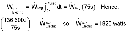

What average power does the water experience?
♦ The work, expressed as the integral of a work rate over the event time is:
Equation (9): W₁₋₂,Electric = ∫ from 0+ to 75 sec of Ẇ(t)_Electric dt
(9) 9
This cannot be integrated as is. We apply the Mean Value Theorem to obtain:
Equation (10): W₁₋₂,Electric = Ẇ_avg ∫ from 0+ to 75 sec of dt = Ẇ_avg (75 s). Hence, (136,500 J/75 s) = Ẇ_avg,Electric, so Ẇ_avg,Electric = 1820 watts
(10) 10
It is emphasized that the above calculations are actual accomplishments of the microwave; energy that indeed arrived to the water. As for the machine, how much of the power from the household electric network it squandered, we don't know.
