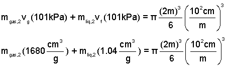

Calculate the amount of liquid when the port pops open. In the second state, the original mass will be part liquid with the specific volume of state (2f), and part vapor with the specific volume, of
state (2g). Equations for the sums of their masses and volumes are:
m_steam,2 + m_liq,2 = 1,471 g; (mv)_steam,2 + (mv)_liq,2 = V
Making the equation immediately above explicit, we have:
m_gas,2 v_g(101 kPa) + m_liq,2 v_f(101 kPa) = π ((2 m)³/6)(10² cm/m)³; m_gas,2 (1680 cm³/g) + m_liq,2 (1.04 cm³/g) = π ((2 m)³/6)(10² cm/m)³
Now we have two equations with two unknowns:
m_steam,2 (1680 cm³/g) + m_liq,2 (1.04 cm³/g) = π ((2 m)³/6)(10² cm/m)³
By solution of these equations, we determine the mass of the liquid to be:
mliq,2 = 1238 g

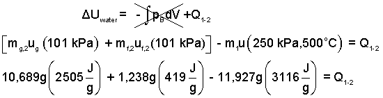

Calculate the average rate of cooling of the vat. Yardley was thinking about air-conditioning for the vat room. The a/c unit would have to match the cooling of the steam in the vat which happened in about one hour. The steam has negligible kinetic and potential energy changes. And since its volume is constant, there is no work. All of the heat passes to the surrounding ambient air. Thus our energy equation is:
ΔU_water = −∫p_B dV (struck out) + Q₁₋₂; [m_g,2 u_g(101 kPa) + m_f,2 u_f,2(101 kPa)] − m₁ u(250 kPa, 500°C) = Q₁₋₂; 10,689 g (2505 J/g) + 1,238 g (419 J/g) − 11,927 g (3116 J/g) = Q₁₋₂
Calculation of the vat cooling (negative heating) rate is as follows.
−9.87 × 10⁶ J = Q₁₋₂; Q₁₋₂ = ∫ from 0 to 3600 sec of Q̇ dt = Q̇_avg (3600 sec); Q̇_avg = −9.87 × 10⁶ J / 3600 sec = −2.74 kW
The negative sign means the heat transferred from the steam to the surroundings (as we expected).
