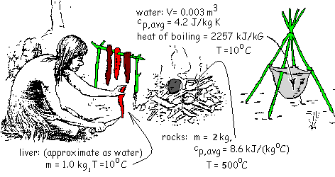

Stone Boiling
Indians of the early Southwest used the technique "stone boiling" to cook tender parts of bison, particularly the liver. Upon a successful hunt the paunch and liver were cut from a bison. Fire wood was gathered, stacked in criss-crossed layers, topped with stones then set afire. Nearby, the paunch was inverted, filled with water and hung upon a tripod of branches.
Sketch of stone boiling: a person beside a fire with heated rocks (m = 2 kg, c_p,avg = 8.6 kJ/(kg °C), T = 500°C), strips of liver (approximated as water, m = 1.0 kg, T = 10°C), and a hide pouch of water hung from a tripod (V = 0.003 m³, c_p,avg = 4.2 J/(g K), heat of boiling = 2257 kJ/kg, T = 10°C).
As one Indian sliced liver, others replenished the fire until the stones were very hot. Finally using sticks the "cook" lifted the hot stones from the fire and dropped them, along with sliced liver, into the bag of water. A sketch of the event with the initial conditions of the stones, liver and water, is shown.
Determine the second temperature of the rock, water and liver in the bag.

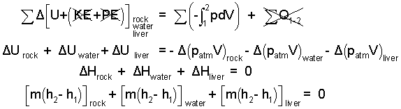

System and energy equation
♦ We take the rock, water and liver (approximated as an equal mass of water) as system. Ignore the thermal effects of the paunch. A precise second temperature cannot be determined because there will be heat to the cold atmospheric surroundings. The best we can do at this level is to approximate the event as adiabatic and calculate the greatest possible second temperature of the liver and water. There will be negligible kinetic and potential energy changes. The energy equation and its reduction for this event is:
Equation (1): ΣΔ[U + (KE + PE) (struck out)] (rock, water, liver) = Σ(−∫ from 1 to 2 of p dV) + ΣQ₁₋₂ (struck out); ΔU_rock + ΔU_water + ΔU_liver = −Δ(p_atm V)_rock − Δ(p_atm V)_water − Δ(p_atm V)_liver; ΔH_rock + ΔH_water + ΔH_liver = 0; [m (h₂ − h₁)]_rock + [m (h₂ − h₁)]_water + [m (h₂ − h₁)]_liver = 0
(1) 1
The rock is initially 500°C and the water and liver 10°C. Once together, a second, uniform temperature will be attained. There is no heat for this event because (i) we assume heat to the surrounding air as zero and (ii) we defined both the rock, water and liver as system. Such thermal aspect here is not heat but "thermal equilibration".

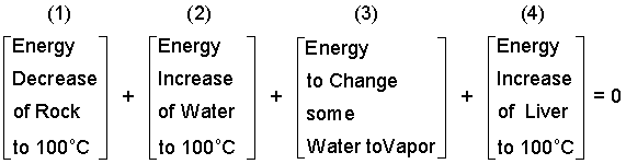

Next we "postulate" the energy changes.
Equation (8): (1) [energy decrease of rock to 100°C] + (2) [energy increase of water to 100°C] + (3) [energy to change some water to vapor] + (4) [energy increase of liver to 100°C] = 0
(8)8

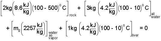

By our assumption of liquid and vapor water in the second state, the second temperature will be 100°C which we use in the next equation. We have kept the terms in position. Next we enter data for specific heats and the enthalpy boiling, hfg
Equation (9): [2 kg (8.6 kJ/kg)(100 − 500)°C]_rock + [3 kg (4.2 kJ/kg)(100 − 10)°C]_all water + [m_g (2257 kJ/kg)]_water as vapor + [1 kg (4.2 kJ/kg)(100 − 10)°C]_liver = 0
(9) 9
The only unknown quantity becomes the mass of the water (mg) that is vapor upon conclusion of the assumed adiabatic event.
By careful calculation, the equation yields the amount of gas (or vapor) created to be,
mg = 2.4kg. Consequently the second temperature is T2 = 100°C.
