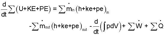

Next we address the energy equation.
Equation (11): d/dt Σ(U + KE + PE) = Σṁ_in (h + ke + pe)_in − Σṁ_out (h + ke + pe)_out − d/dt (∫p dV) + ΣẆ + ΣQ̇
(11)
For the pressure cooker...
(i) The system is only water so drop the 1st and 2nd summation signs (Σ).
(ii) The "in" terms do not apply.
(iii) Constant volume cooker has no "dV" hence no "pdV" work."
(iv) Kinetic and potential energy changes will be negligible.
(v) Assume there is no heat to the surrounding space. Drop the summation (Σ).
With these facts about the system, our equation reduces to this:
Equation (12): d/dt (U) = −ṁ_out (h)_out + Q̇
(12)
