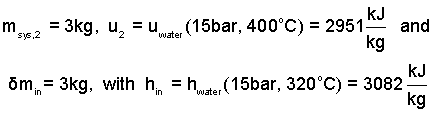

For equation (8) we have determined the values for the masses involved. Also we have the needed internal energy and enthalpy from property tables for water.
Equation (9): m_sys,2 = 3 kg, u₂ = u_water(15 bar, 400°C) = 2951 kJ/kg, and δm_in = 3 kg, with h_in = h_water(15 bar, 320°C) = 3082 kJ/kg
(9)(9)
Applying the known quantities to equation (8) we obtain.
Equation (10): 3 kg (2951 kJ/kg) = 3 kg (3082 kJ/kg) + W_sys,1-2
