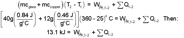

Calculate the least electric work delivered to the tube.
♦  The sketch shows a section of a sign that needs to be heat-treated to 360oC. The specific heats of glass and copper are 0.84 J/(g°C) and 0.46 J/(g°C), respectively. Ignore thermodynamic effects of the gas contained within the tube.

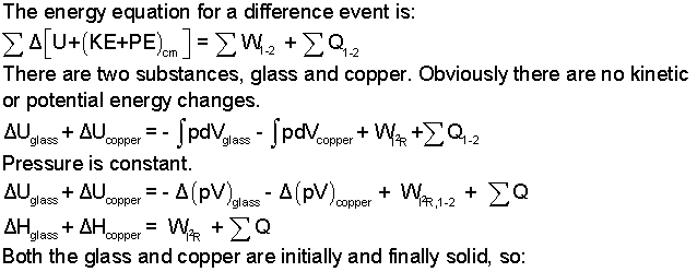

Neon Signage Eqn1a
Neon Signage Eqn1b
Notice the usual treatment of the work integral. Atmospheric pressure is constant hence - patm∫dV becomes - pΔV. Admittedly the ΔV's are small but they need not be thrown away. Combine them as ΔU + Δ(pV) to obtain ΔH. Specific heats are associated with internal energy change and with enthalpy change; for solids or liquids these specific heats are near identical, numerically.
Observe the last equation (above) of our solution. We see the amount of electrical resistance power, I2R, cannot be calculated because we do not know the sum of the heats. To calculate the sum of heats requires knowing temperature differences of the glass and copper in time, the surface area of the glass and some other experimental numbers. Those are topics of heat transfer. Since the glass and copper get hot, there will be heat and it will be (negative) to the surroundings. Consequently our answer based upon the assumption of no heat will be smaller than actual whereupon the actual electrical power must be:
Neon Signage Eqn2
