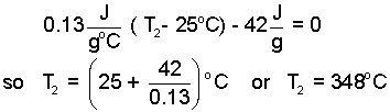

Here, cs,avg represents the average specific heat of solid lead on the temperature range 25°C to T2. Since we don't know T2, we can only approximate cs,avg. We take the average value to be the table value; 0.13 J/g°C. (Note: we can later refine this approximation). We substitute Eqn-8 into Eqn-5 and solve for the second temperature.
Equation (9): 0.13 (J/(g °C))(T₂ − 25°C) − 42 J/g = 0, so T₂ = (25 + 42/0.13)°C, or T₂ = 348°C
(9) The use of an approximate average specific heat allows
us to proceed to a solution; to obtain an approximate second
temperature, from which (availability of data permitting) a
second, better average specific heat can be determined, and
with which a second iteration of calculation can be made...
The process will converge.
So what do we have? To expedite solution we assumed the final state would be solid. We cast the second enthalpy from that perspective. Carrying that assumption our solution is that the second temperature of the lead is 348°C.
However property data indicate lead is LIQUID for temperatures greater than 327°C. We have a contradiction. Since our answer is wrong, our assumption was wrong. Nonetheless, that calculation has value. "All solid" is excluded from reality. There will be "some solid and some liquid" or there might be all liquid or... with patience we will learn what happened to the Minie ball.

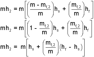

Now, separate from Eqn-11, we are going to rearrange mh2 to reflect that the lead after impact is part solid (s,2) and part liquid (f,2) ("f," means fluid or liquid). Finally the mass is:
Equation (12): m = m_s,2 + m_f,2
(12) 13
The second enthalpy, H₂ (or mh2) will equal the mass of solid times the saturated solid enthalpy added to the mass of liquid times the saturated liquid enthalpy, Eqn-13.
Equation (13): m h₂ = m_s,2 h_s + m_f,2 h_f
(13) 13
The right side is multiplied and divided by the mass (sum of components).
Equation (14): m h₂ = m [(m_s,2/m) h_s + (m_f,2/m) h_f]
(14) 14
But we also have:
Equation (15): m_s,2 = m − m_f,2
(15) 15
Upon substitution of Eqn-15 into Eqn-15 and rearranging (just a tad) begets Eqn-16.
Equation (16): m h₂ = m [((m − m_f,2)/m) h_s + (m_f,2/m) h_f]; m h₂ = m [(1 − m_f,2/m) h_s + (m_f,2/m) h_f]; m h₂ = m [h_s + (m_f,2/m)(h_f − h_s)]
(16) 16
Here it is appropriate to introduce two definitions. Of the phases, solid and liquid, liquid has the higher energy. For any two-phase situation we define quality, x: to be the ratio, "mass of the higher energy component" divided by "the sum of masses (both components)" - Eqn-17.
Equation (17): x_sf ≡ m_higher energy fraction / m_both fractions = m_f/(m_s + m_f) = m_f/m
(17) 17
The latent heat of fusion (same as melting) is the energy difference: enthalpy of saturated fluid minus enthalpy of the saturated solid.
Equation (18): h_sf ≡ h_f − h_s
(18) 18
Now insert the definitions, Eqn-17, 18, into the result of Eqn-16 yields Eqn-18commonly used definitions permit mh2 to be written as:
Equation (19): m h₂ = m (h_s + x_sf h_sf)
(19) 19
