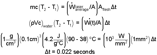

Bring the term, "pdV", th the left. Pressure is constant, the term combines with "du" to become "dh." Next apply integrals:
m ∫ from 1 to 2 of dh = ∫ from 1 to 2 of (Ẇ(t)/A) A_flesh dt
The differential, dh, is called exact; it integrates immediately. We use an average specific heat to represent the enthalpy difference. The laser power is a function of time, W-dotlaser/A(t) and area. It might be that the device has a start-up transient. But our calculation is preliminary so we apply the mean value theorem to effect the integration. Also apply the numbers and properties of water.
m c (T₂ − T₁) = (Ẇ_laser,average/A) A_flesh Δt; (ρVc)_water (T₂ − T₁) = (Ẇ/A) A Δt; (1 g/cm³)(0.1 cm)³ (4.2 J/(g °C))(90 − 38)°C = (10³ W/mm²)(1 mm²) Δt; Δt = 0.022 seconds
The mechanism of the laser is work. The effect is increased temperature. The trauma of being seared causes the tissue to adopt a "heal and repair" physiological mode. The sear does not occur as a consequence of temperature difference, hence is not heat.
