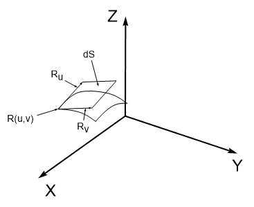

The element of surface area
Suppose we examine a point ##\vec R(u,v)## on the surface and the parameter curves through ##\vec R(u + \Delta u,v)## and ##\vec R(u, v+\Delta v)## as well as the tangent vectors ##\vec R_u(u,v)## and ##\vec R_v(u,v)##.
The tangent vectors form the sides of a parallelogram tangent to the surface whose area is ##|\vec R_u \times \vec R_v|##. This tells us that a rectangle in the ##u,v## plane with small sides ##\Delta u## and ##\Delta v## with area ##\Delta u \cdot \Delta v## is mapped to a region ##\Delta S## on the surface whose area is approximated by ##|\vec R_u \times \vec R_v|\Delta u\Delta v##. For this reason the element of surface area is defined to be$$dS = |\vec R_u \times \vec R_v|dudv$$and I will refer to ##|\vec R_u \times \vec R_v|## as the “scaling factor” of the transformation. This formula is important because surface integrals are always evaluated by calculating in the parameter space.
