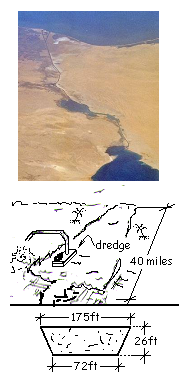

The Suez Canal was dug across 40 miles of desert by a team of dredges. The canal initiated in a lake at its north end. It was "dug" by pumping a water-saturated sand mix (slurry) from the canal to a bank about half a mile away. The average rate of sand removed by the digging machines was six million cubic feet per month. The figure shows a pictoral view of the completed canal and a sketch of the canal average profile.
Estimate the number of years required to dig the canal.

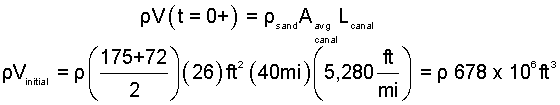

Next we apply integration operators. The lower limits (both integrals) are associated with the initial state of the canal and the initial time of digging. By the calculation below we know the initial volume of sand the is 678 million cubic feet; this is the lower limit of the left-of-equality integral and the lower limit of the integral right-of-equality is the time, t = 0+.

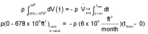

The upper limits of the integrals are associated with the final conditions of system properties and the ending time of digging. The final volume (the volume of sand in the canal once all sand has been removed) is zero. So the upper limit left-of-equality is zero cubic feet. And correspondingly the limit right-of-equality is the unknown time of finish. Place limits on the integrals:
Suez 7
(7)
The mean value theorem of calculus is needed.
The integral right-of-equality poses a problem because we don't know the time wise volume rate of the dredges. Maybe the dredges were broken down much of the time. Or fewer pumps might have operated to begin the dig and more were added later. There is no way for us to know. What to do?
To proceed we are going to do something that is done VERY OFTEN in thermodynamic and engineering analysis. We apply the Mean Value Theorem to the integral by using the number given as an average. We assume six million cubic feet per month as the average removal rate. Both integrals are of "exact differentials" now. These integrate promptly.
Suez 8
(8)
The integrand of the exact differential
is “1.” Fun to integrate these!
Now divide the equation by the density. Make sure the units behave.
