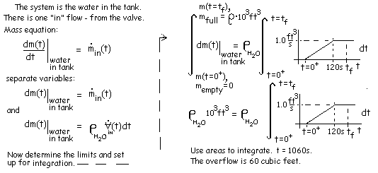

Sketch of a water supply valve filling a tank 10 ft by 10 ft and 10 ft deep, with a graph of volume flow rate V̇(t) rising linearly to 1 ft³/s over 120 s: the valve requires 120 seconds from full open to full closed.
The supply of water to an empty tank is controlled by a valve which is initially closed. While opening the valve, the flow of water (into the tank) increases linearly. To open the valve completely requires two minutes and when the valve is "full-open" one cubic foot per second of water flows into the tank. The time required to close the valve completely is also two minutes.
Calculate the least time required to fill the tank and the overflow that will happen.
♦ To fill the tank in the least time, the valve is left full-open until the water level attains the top of the tank. Thereafter, while the valve is being shut, overflow will occur.
The system is the water in the tank. There is one in-flow, from the valve. Mass equation: dm(t)/dt (water in tank) = ṁ_in(t); separate variables: dm(t) = ṁ_in(t) dt and dm(t) = ρ_H₂O V̇(t) dt. Now determine the limits and set up for integration: from m_empty = 0 at t = 0+ to m_full = ρ 10³ ft³ at t = t_f, with the flow-rate graph rising to 1.0 ft³/s at 120 s. Use areas to integrate. t = 1060 s. The overflow is 60 cubic feet.

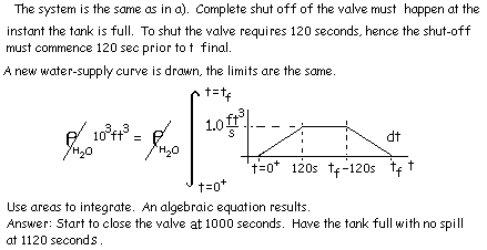

Calculate the least time to fill the tank with zero overflow.
♦ To prevent overflow one must have the valve "shut" the very moment the tank is full. Shutting the valve requires time. So we need to know at what time after the start (t = 0+) "closing" of the valve must commence?
The system is the same as in a). Complete shut-off of the valve must happen at the instant the tank is full. To shut the valve requires 120 seconds, hence the shut-off must commence 120 sec prior to t_final. A new water-supply curve is drawn, rising to 1.0 ft³/s at 120 s and falling to zero between t_f − 120 s and t_f; the limits are the same. Use areas to integrate. Answer: start to close the valve at 1000 seconds; have the tank full with no spill at 1120 seconds.
