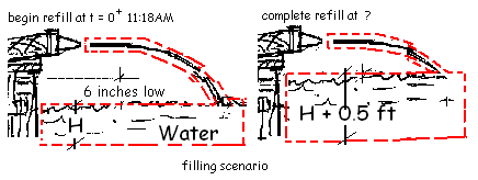

Sketch of a hose with nozzle area 0.003 ft² at the top of a pool wall, the stream landing 1.5 feet out and 0.6 feet below the nozzle; the pool water is 6 inches low.
Suppose you noticed the water level of your neighbor's swimming pool to be about 6 inches low. You inform him of the fact whereupon he directs a garden hose into the pool and turns it on. The pool has vertical sides and measures 15 by 36 feet.
The sketch shows the geometry of this "pool filling" event. For a moment the two of you watch the water flowing into the pool. Sketch of the stream trajectory in X–Z axes: P(t = 0+) = 0 I + 0 K, V(t = 0+) = V_in horizontal; the droplet lands 1.5 ft out and 0.6 ft down, P(t = t*) = 1.5 ft I − 0.6 ft K. Then, knowing you are an engineer, the neighbor asks: "When should I return and turn the water off?"

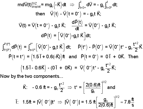

♦ Step One: First we use the geometry of the flow and its conditions to solve the momentum equation for the velocity of the water issuing from the hose. We take the system to be a small droplet or amount of the that issues from the hose then free-falls to the water. The general geometry with coordinates, the initial, and final positions of the water are shown to the right.
We take an amount of water exiting the nozzle. With the nozzle exit as origin, Newton's 2nd Law applies with gravity as the acting force:
Equation (1): d(mV)/dt (droplet of water, 0XZ) = m g_o (−K)
(1)
Eqn. 1 is called the governing equation. Two conditions that apply are the position at start (2) and the position of entry into the water (3).
Equation (2): P(t = 0+) = 0 I + 0 K
(2)
Equation (3): P(t = t*) = (1.5 I + 0.6 (−K)) ft
(3)
Careful solution of the differential equation (with conditions) proceeds as follows.
m dV(t) (droplet, 0XZ) = m g_o (−K) dt ⇒ ∫ dV = −g_o ∫ from t = 0+ to t of dt; then V(t) − V(t = 0+) = −g_o t K; V(t) = V(t = 0+) − g_o t K; dP(t)/dt = V(0+) − g_o t K; dP(t) = [V(0+) − g_o t K] dt; ∫ from P(0+) to P(t*) of dP(t) = ∫ from t = 0+ to t* of [V(0+) − g_o t K] dt; P(t*) − P(0+) = V(0+) t* − g_o (t*²/2) K; P(t = t*) = (1.5 I + 0.6 (−K)) ft and P(t = 0+) = 0 I + 0 K. Then (1.5 I − 0.6 K) − (0 I + 0 K) = V(0+) t* − g_o (t*²/2) K. Now by the two components… K: −0.6 ft = −g_o t*²/2 ⇒ t* = [2 (0.6) ft / g_o]^(1/2), and I: 1.5 ft = |V(0+)| t* ⇒ |V(0+)| = 1.5 ft [g_o / (2 (0.6) ft)]^(1/2) = 7.8 ft/s
Step Two: Our next task is to define a system and apply the mass equation. The sketch shows the pool before and after the fill.
Filling scenario: refill begins at t = 0+ (11:18 AM) with the pool water 6 inches low at height H; refill is complete at an unknown time with the water at H + 0.5 ft.

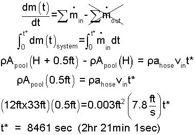

The system is the water in the pool which has the initial depth, H and the final depth is H + 0.5 ft. Solution of the mass equation is as follows:
dm(t)/dt = Σṁ_in − Σṁ_out (struck out); ∫ from 0 to t* of dm(t)_system = ∫ from 0 to t* of ṁ_in dt; ρA_pool (H + 0.5 ft) − ρA_pool (H) = ρ a_hose v_in t*; ρA_pool (0.5 ft) = ρ a_hose v_in t*; (12 ft × 33 ft)(0.5 ft) = 0.003 ft² (7.8 ft/s) t*; t* = 8461 sec (2 hr 21 min 1 sec)
