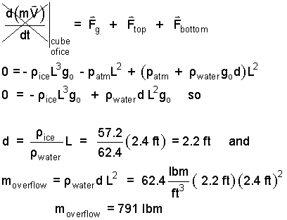

♦ A mass of crushed has the same volume as a block of ice with the same mass. For our purposes we model the "crushed ice" as a large cube of ice. From tables, the density of ice is 57.2 lbm/ft3. Thus the length of one edge of an 800 lbm cube of ice is:
Equation (1): m = ρV = ρ_ice L³; 800 lbm = 57.2 (lbm/ft³) L³, therefore L = 2.4 ft
(1) 1
Sketch of a cube of ice of side L floating in water with depth d submerged, with atmospheric pressure p_atm above. The sketch shows our imaginary cube of ice in its floating position in the pool. Since the pool was initially completely full, the volume of the cube below the water surface equals the volume of water that was displaced onto the deck. Our system is the cube of ice. We use the momentum equation. The condition of the ice is that of uniform motion (with zero velocity). The sum of forces that act on the cube equals zero, 0 = ΣF. We use this fact to calculate the depth of floating, d.
Equation (2): d(mV)/dt (cube of ice, struck out as zero) = F_g + F_top + F_bottom; 0 = −ρ_ice L³ g_o − p_atm L² + (p_atm + ρ_water g_o d) L²; 0 = −ρ_ice L³ g_o + ρ_water d L² g_o, so d = (ρ_ice/ρ_water) L = (57.2/62.4)(2.4 ft) = 2.2 ft and m_overflow = ρ_water d L² = 62.4 (lbm/ft³)(2.2 ft)(2.4 ft)²; m_overflow = 791 lbm
(2) 2

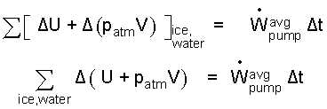

But patm is constant, so this compression work is rewritten (Δ(pV)) and moved to the left of the equality to become:
Equation (6): Σ[ΔU + Δ(p_atm V)]_ice,water = Ẇ_avg,pump Δt; Σ over ice and water of Δ(U + p_atm V) = Ẇ_avg,pump Δt
(6) 6
We see the groups, U + patmV. These are enthalpies, H.
Equation (7): ΣΔH_ice,water = Ẇ_avg,pump Δt

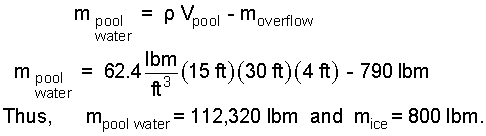

The masses involved are the mass of pool water (remaining) and the mass of solid ice:
Equation (9): m_pool water = ρ V_pool − m_overflow; m_pool water = 62.4 (lbm/ft³)(15 ft)(30 ft)(4 ft) − 790 lbm. Thus, m_pool water = 112,320 lbm and m_ice = 800 lbm.
(9) 9

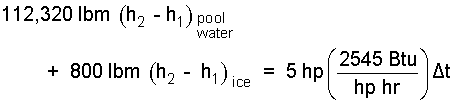

The energy equation is expanded:
Equation (10): 112,320 lbm (h₂ − h₁)_pool water + 800 lbm (h₂ − h₁)_ice = 5 hp (2545 Btu/(hp hr)) Δt
(10) 10

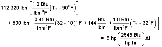

The event of the ice involves energy increase with melting at constant pressure. The energy change is that of enthalpy. The energy of the second state of the water (that was originally solid) will be greater than it was initially. The second enthalpy equals the first enthalpy, plus the energy to warm it to 32°F plus the energy to melt it plus the energy to warm it above 32°F to 0 T2.
Equation (12): h_ice,2 = h_ice,1 + c_sol (32 − 10)°F + h_sol-liq + c_liq (T₂ − 32°F), so (h₂ − h₁)_ice = c_sol (32 − 10)°F + h_sf + c_liq (T₂ − 32°F)
(12) 12
The specific heat used as the ice warms to melting temperature is 0.45 btu/lbmoF (row 3, col 1; EE units). The heat of fusion, hsf is listed as 144 btu/lbmoF (row 3, col 2; EE units) We enter the masses, the appropriate specific heats, and the latent heat of fusion of water.
Equation (13): 112,320 lbm [(1.0 Btu/(lbm °F))(T₂ − 90°F)] + 800 lbm [(0.45 Btu/(lbm °F))(32 − 10)°F + 144 Btu/lbm + (1.0 Btu/(lbm °F))(T₂ − 32°F)] = 5 hp (2545 Btu/(hp hr)) Δt
(13) 13

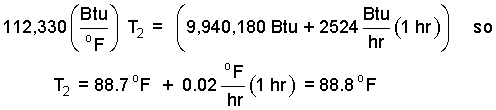

Check to see that the above is correct, then collect.
Equation (14): 112,330 (Btu/°F) T₂ = (9,940,180 Btu + 2524 (Btu/hr)(1 hr)), so T₂ = 88.7°F + 0.02 (°F/hr)(1 hr) = 88.8°F
(14) 14
