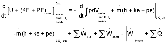

♦ We take the water to be the system and we write the Energy Equation:
Equation (1): d/dt [U + (KE + PE)_c.m.] (water and CO₂ inside, 0XZ) = −d/dt ∫p dV (water and CO₂ inside) + ṁ (h + ke + pe) at CO₂ in − ṁ (h + ke + pe) at CO₂ out + ΣẆ_ext + ΣẆ_shaft − |Ẇ|_friction + ΣQ̇
(1) 1
Our system (called "open" by some) is a constant amount of water and carbon dioxide within it. The CO2 passes through as a "stream." Since 5°C is maintained,dU/dt of the system equals zero. With our space reference,(0XZ),attached to the floor of the aquarium,dKE/dt and dPE/dt are also equal to zero. Inspecting of the compression work rate we realize the system volume is constant hence dV/dt equals zero ~ the first term right of equality is zero. The entering ke and pe (lower case to be per-unit-mass) of the carbon dioxide is approximately equal that of the exiting flow. Sum these to zero. In the reference,the center of mass of the water does not move hence and there is no motor or pump hence the extrinsic work rate and shaft work rate are zero.
Equation (2): 0 = ṁ_CO₂ (h_in − h_out) at CO₂ + Q̇_from Maeku + Q̇_water surface
(2) 2

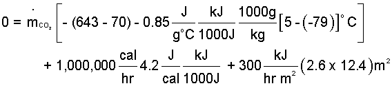

Applying numbers to equation (6):
Equation (7): 0 = ṁ_CO₂ [−(643 − 70) − 0.85 (J/(g °C))(kJ/1000 J)(1000 g/kg)[5 − (−79)]°C] + 1,000,000 (cal/hr)(4.2 J/cal)(kJ/1000 J) + 300 (kJ/(hr m²))(2.6 × 12.4) m²
(7) 7

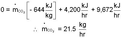

Follow through with the numbers carefully (is this right?):
Equation (8): 0 = ṁ_CO₂ [−644 kJ/kg] + 4,200 kJ/hr + 9,672 kJ/hr, ∴ ṁ_CO₂ = 21.5 kg/hr
(8) 8
There was no reason to algebraically manipulated the equation. Things were complicated enough, as is.
