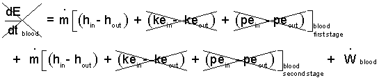

In setting up the energy equation, the change of energy of the blood while in the heart is zero (dE/dt = 0). We write "energy with mass flow" in two pieces which are energy changes of the "first stage" and the "second stage" of the heart. The potential and kinetic energies differences, "entering (in) minus leaving (out)" are assumed very small.
Equation (2): dE/dt (blood, struck out) = ṁ [(h_in − h_out) + (ke_in − ke_out) + (pe_in − pe_out)] (blood, first stage) + ṁ [(h_in − h_out) + (ke_in − ke_out) + (pe_in − pe_out)] (blood, second stage) + Ẇ_blood, with the ke and pe terms struck out
(2) 2
The mass rates are equal through each stage. The enthalpies contain internal energies of the blood. We assume the entering and leaving internal energies are equal such that what remains are p/ρ terms.

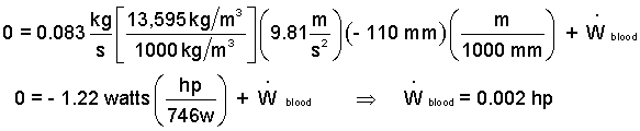

Equation (5): 0 = 0.083 (kg/s)[(13,595 kg/m³)/(1000 kg/m³)](9.81 m/s²)(−110 mm)(m/1000 mm) + Ẇ_blood; 0 = −1.22 watts (hp/746 W) + Ẇ_blood ⇒ Ẇ_blood = 0.002 hp
(5) 5
Our calculations show work to the blood as positive. In passing through the heart the blood gains 0.002 horsepower of energy. From the standpoint of the heart, energy passed from it to the blood in the amount:
Equation (6): Ẇ_heart = −0.002 hp
(6) 6
A second check of the equation-stream shows the resulting minus sign to be correct. Also, the physics is correct; The energy transfer (work of the heart) is energy that passes from the heart muscles to become energy of the flowing blood.
