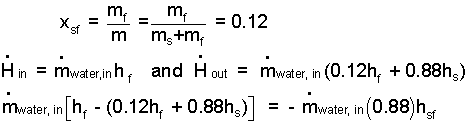

The water enters as saturated liquid. The exiting flow is 88% solid and 12% liquid.
Equation (4): x_sf = m_f/m = m_f/(m_s + m_f) = 0.12; Ḣ_in = ṁ_water,in h_f and Ḣ_out = ṁ_water,in (0.12 h_f + 0.88 h_s); ṁ_water,in [h_f − (0.12 h_f + 0.88 h_s)] = −ṁ_water,in (0.88) h_sf
(4) 4

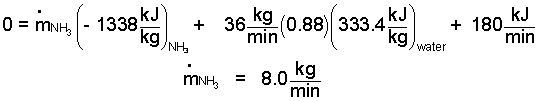

Putting these numbers in the energy equation with the motor power gives:
Equation (5): 0 = ṁ_NH₃ (−1338 kJ/kg)_NH₃ + 36 (kg/min)(0.88)(333.4 kJ/kg)_water + 180 kJ/min; ṁ_NH₃ = 8.0 kg/min
(5) 5
Again, our numbers are approximate. The very cold temperature will enhance heat from the surroundings.
