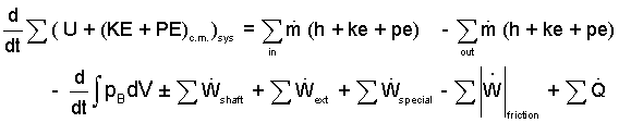

This energy equation is long because it contains representational terms for all types of interaction. It is a load to write out seen to be useful as non-applicable terms are removed. We write it out every time because it contains all terms that might apply.
Equation (3): d/dt Σ[U + (KE + PE)_c.m.]_sys = Σ_in ṁ (h + ke + pe) − Σ_out ṁ (h + ke + pe) − Σ d/dt ∫p_B dV ± ΣẆ_shaft + ΣẆ_ext + ΣẆ_special − Σ|Ẇ|_friction + ΣQ̇
(3)3
Equations 1,2 and 3 contain "all of the terms" in general. The equation applies by reduction to the system perspectives, open, closed or unsteady, by its specialization by striking out the inapplicable terms.

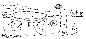

Hand sketch of the pump system under water: a fixed volume (V_sys = const) with water drawn in from all around and pushed out through the pipe at V_out, with shaft work Ẇ_s.
Constant volume system is open
with an infinite, “free surface”
entrance and a “finite” exit.
Open System Perspective
The system is the water that passes through the pump. The system is not "parts of the pump, pipes et al." The sketch to the right represents our system as the constant volume of water contained within an imaginary, dotted boundary. Water enters the system across its "in" boundary, at all places on the perimeter of a large circular annulus shown as a "dashed" ellipse. The pump (not shown) drives water from the space to an exit and "up the pipe." The pump supplies power to the water. It is represented schematically as its power input, Ws. We reduce the mass and energy equation terms proceeding "left to right" as they appear in the equation.

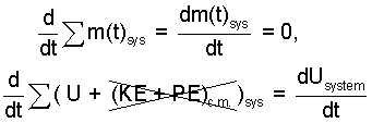

Their is a single mass of the system, (m), and it is constant. The system energies KE and PE relate to the motion and elevation of the center of mass of the system. The center of mass does not move, hence the derivatives of KE and of PE are zero. The left-of-equality terms are as follows:
Equation (4): d/dt Σm(t)_sys = dm(t)_sys/dt = 0; d/dt Σ(U + (KE + PE)_c.m. (struck out))_sys = dU_system/dt
(4) 4
The system has only one entering stream and one leaving stream. Further steps for the mass equation are:
Equation (5): 0 = ṁ(t)_in − ṁ(t)_out, or ṁ = ṁ_in = ṁ_out
(5)5

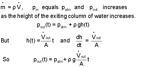

Equation (14): ṁ = ρV̇; p_in equals p_atm and p_out increases as the height of the exiting column of water increases: p_out(t) = p_atm + ρgh(t). But h(t) = (V̇_out/A) t and dh/dt = V̇_out/A. So p_out(t) = p_atm + ρg (V̇_out/A) t
(14) 14

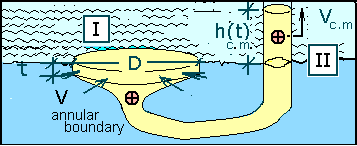

Closed System Perspective
To analyze the pumping from a closed perspective we divide the large mass of water into two parts. The larger part, II is essentially inactive. The mass equation for the system's two parts is:
Sketch of a constant-mass system: region I, the water in the lake above an annular boundary around an inlet disc of diameter D with inflow V, and region II, the column in the pipe of height h(t) whose center of mass rises at V_c.m.

This PE and KE belong to the "part I" water in time as it proceeds up the pipe. There is no water in the pipe initially. The speed the surface of the water moves upward equals dh(t)/dt which equals the volume rate of the pump divided by the pipe area. The center of mass is located at h(t)/2. The result of this analysis is the same as the previous open system analysis.
