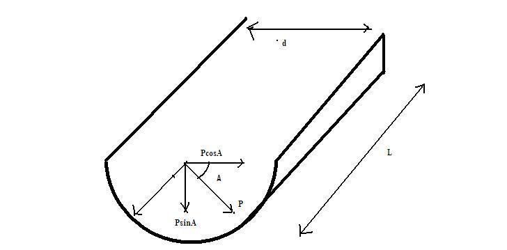

HI Unrest,
Here's my approach to what could be a simple mathematical proof...but there's something wrong...any idea what it is?...
According to the picture I've attached, the Pressure acts in radial lines on the surface of the cylinder...it has two components PcosA and PsinA...while considering half of the crossection of the cylindrical pipe, the components PcosA cancel out...then we get the total vertical pressure on the half-crossesction of the pipe as integral(PsinA) within the limits 0 to pi...that gives 2P, not P...also, if we use this method to analyse a full crossesction of the pipe (considering the uppur half of the pipe also), then all the components PcosA as well as PsinA will get canceled ans there'll be no resultant pressure!
Here's the pic

Pressure is a scalar, force is a vector.
You don't resolve pressure.
It sounds reasonable, but as studiot said, you're calling force pressure. If you call it force, then it's fine. The half pipe gets only a net downward force, and the complete pipe gets zero net force. You'd expect zero net force on the complete pipe because it doesn't get pushed sideways.
But it doesn't quite count as a proof because it only works for a cylindrical pipe. You might as well use a square pipe and it'd be even easier!
Hmm, okay, but then what is the proof?

OKay...but we were trying to prove that the net effect of pressure in any direction will be equal to the area of the cut plane times the pressure... like what Cyrus said...
Yea I understand that. I just don't quite have my 'proof' complete. The integral I showed should be the net force caused by pressure on an arbitrarily shaped surface S (such as your half pipe). So if you can prove that it's equal to the integral over any other surface with the same boundary, then you can choose to use the flat surface directly across the cut.
Writing it this way takes the details of the physics out of the picture. It's just the integral of the normal vectors of a surface. It seems intuitive that that should be zero for a closed surface, and for an open surface (like our case), it should be independent of the shape.
I suspect you can use the same kind of theorum as for proving the Archimedes principle, as well as Gauss's law as Cyrus said.
