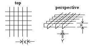

I'm not sure on the sizes of the Xs and Y, and… how would I get out of the outer sphere? I guess that the frame could be chain-linked.
The squares in between the segments would be connection points, or maybe the segments could just attach to each other? With a chain-link, I could detach certain links, somehow, and create a door for myself. Anyway, with this setup, I could install hoses to spray off debris.

Cliff - On visibilty; the transparent sphere is on the inside of another wire frame type sphere which is thin from the drivers perspective, thick from the side, if you can picture, this sphere having a... maybe 3 feet larger radius. Hoses could be installed on the inner sphere, installed like windshield washer nozzels, or something. On torque, and the inner spinning, also responding to SaMx; I realize that this is a big issue, maybe the biggest. The second sketch is on this inner spinning topic, depicting the axel heads on both sides of an axis (non-friction, electrical magnets, more or less connecting, but not LOCKING to the wire frame) somewhat connecting to the wire frame, while detaching from the axel, but... you know, perhaps that's not really even needed, because remember, the axel heads aren't actually CONNECTED to the outside sphere, other than magnetically, they are coated in a super-non-friction material, as is the inside of the outer sphere. This super-non-friction connection together with a low-seated engine (weight) should counteract the "gerbiling" effect shouldn't it? yes, in more extreme cases, the inside stuff would start to spin, but only for a short while, it seems. On seeing through the metal; I had spoken of thin Titanium, which would be able to resist denting, but the transparent sphere is on the inside anyway, so it could just be fiber glass or something. On the sketches, the first is my original, and very bad concept, the third is a more recent concept. Here are some more sketches; the outside sphere grate sizes, that I am unsure of; shock movement of inside stuff; and outside sphere chain link

OK, I just realized that what I said didn't make any sense, concerning the inside rotation... this is tricky. Perhaps there could be an additional cylinder surrounding the axels, that could be turned in the opposite direction of the axel somehow, no no no... yeah, this torque/girbiling issue might be the catch after all. Well, if the outer sphere was smooth, I guess maybe there could be little wheels on the ends of the axel heads that correspond to the spin direction(s), and could be made to provide a bit MORE torque than the current spin direction, could be turned on the axels heads NOT currently being used for sphere movement, and only supplying the extra torque if and when the inside stuff starts spinning instead of the sphere... possible?
