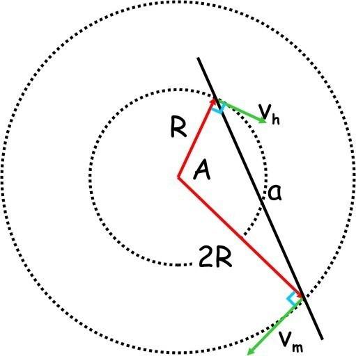

After the remarks by Andrew and nrged I thought I should investigate how the distance between the two endpoints of the hands changes. Here goes:
The angle between the two hands is given by
[tex]A = \theta_m - \theta_m = (\omega_m - \omega_h)t[/tex]
giving
[tex]\dot{A} = \omega_m - \omega_h = \Delta \omega[/tex]
using the cosine rule to determine the distance between the endpoints of the hands one get that
[tex]\frac{a}{R} = \sqrt{5 -4 \cos(A)}[/tex]
(same as arunbg) time derivative of this comes to
[tex]\frac{1}{2R} \dot{a}= \frac{\dot{A}\sin(A)}{\sqrt{5 - 4 \cos(A)}}[/tex]
which needs to be maximized.
Differentiating the las equation again gets me to (I hope someone is checking this):
[tex]\frac{1}{2R\dot{A}^2} \ddot{a} = \frac{B\cos(A) - \frac{2\sin^2(A)}{B}}{B^2}[/tex]
where
[tex]B = \sqrt{5 - 4\cos(A)}[/tex]
multiplying the numerator with B and a little manipulation gives
[tex]\cos^2(A) - 2.5\cos(A) + 1 = 0[/tex]
solving the quadratic shows that
[tex]A = 60^o\ ![/tex]
so the greates rate of separation occurs when the angle between the hands are sixty degrees, which occurs 10 minutes 55 seconds after midnight.

This looks right. The second derivative is a bit of a challenge. As I suspected, the maximum rate of separation occurs when the angle of the line between the ends makes a 90 degree angle with the hour hand ([itex]a^2 = 3R^2 = (2R)^2 - R^2[/itex])!

There is another way of looking at this. Consider the length as a function of the angle between a and the hour hand which we will call [itex]\beta[/itex] and let the minute hand be n*R (R=length of hour hand). By the cosine rule:
[tex]n^2R^2 = a^2 + R^2 - 2aRcos\beta[/tex]
which is a quadratic that has solution:
[tex]a = \frac{-2Rcos\beta \pm R\sqrt{4cos^2\beta +4(n^2-1)}}{2}[/tex]
[tex]a/R = -cos\beta \pm \sqrt{cos^2\beta +(n^2-1)}[/tex]
Then take the second derivative of a with respect to [itex]\beta[/itex]
The second derivative is 0 when [itex]cos\beta = 0[/itex]
Then it is just a matter of applying Pythagoras' theorem to determine the length of a and the angles/times.
