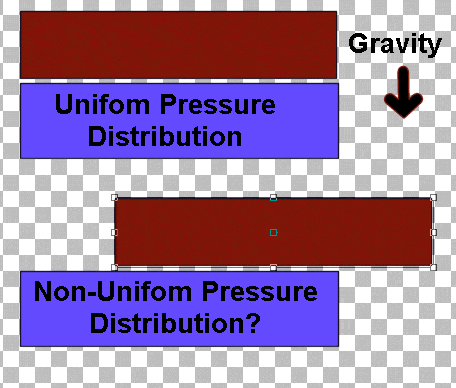

Ugh, I'm not sure if I have anything *nice* that will handle all of the cases, but I'll think about it. You should BTW also check to make sure that you're not calculating torque on the open area.
I'll try to get back to you later tonight.
For now what you can do is to add up the torque first, then multiply the total by the normal force and the force of friction instead of doing it bit by bit. Then you can handle the 'overhang' problem by simply checking the radii when you do the net torque calculation numerically.
Edit:
This isn't exactly clear. What you can do is numerically determine the total area that is in contact so you can get the pressure due to the normal force.
Since you're already doing a numeric operation on the tool surface, it shouldn't be a whole more work.
Hi Nate,
Perhaps a simplification of my current problem is in order. Below is a link to an image showing two situations for the tool(brown) and mirror(blue)
In the top situation, the normal force for friction between the two items should be uniform for each point measured.
In the bottom situation, common sense says the normal force should be greater for points toward the right side of the contact area, and lower for points toward the left side of the contact area.
The problem reminds me of the physics example of "two window washers standing on a platform supported by two cables, wondering how much weight each cable is supporting as they walk about platform"
Thanks,
James
