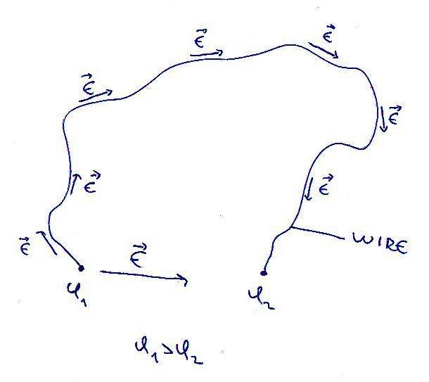

Hi! My exams are coming up soon and I'm revising some of the notions of electromagnetism. What intrigues me is the way electric field is created/distributed within a wire. I've been thinking about it for some time and have come up with the following "hypothesis", idea:
When a conducting wire is connected to a positively charged body, the nearest free electrons of the wire will "jump" on the body (due to the force of the charged body acting on them) and thus "uncover" the positive charge of several nuclei in that part of the wire. These positively charged nuclei will attract electrons situated further along the wire, making them to move and "uncover" another set of nuclei. This process goes on and on until the end of the wire is reached. If this end is connected to a negatively charged body, the process is even more intensified.
What is your approach to this problem? Any help would highly appreciated, since it bothers me quite a lot :)

Yep, I tried to. The electric field created in a wire is always tangential to the wire, in the direction from the point of higher potential to that of lower potential - this field drives free electrons along the wire (in the opposite direction). What I am unsure about is the "mechanism" how this electric field is created - whether it is the way I described it in my first post or any other?

How can the field be created if some parts of the wire are going in the opposite direction than needed, that is if they go from lower potential to higher potential? IFor example, let's say I have a generator and a wire connecting the two terminals making a sort of omega-shape. Some parts of the wire are in the "wrong" direction, namely those closer to the terminals. When this wire is connected to the generator, how does the electric field inside it establish?

I know that voltage = E.Field times the distance in the case of uniform electric field
But I ain't able to comprehend how we're allowed to use this in the case of bent wire [like in the picture in post #8]
It is falsely believed that the source of the Electric Field within a wire carrying a constant current is the charges that are accumulated in the terminals of a battery.
If that was true, the internal Electric Field could not adjust to any change in the geometry of the wire, which is a remarkable attribute.
We should seek elsewhere for the sources and that is on the surface of the conductor. It seems that a linear distribution of surface charges along the wire is responsible not only for the internal Field (of constant magnitude and tangential direction), but also for some Electric Field outside the wire. The role of the battery is to sustain such a charge distribution.
When we bend the wire the surface charges rearrange themselves so that the internal Field remains tangential to the new path.
