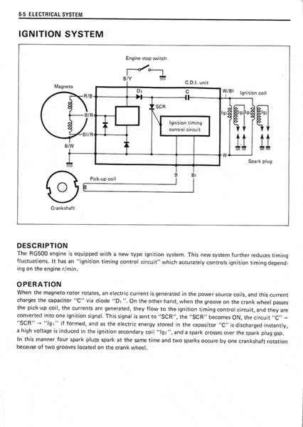

What my question would be is if the engine runs correctly with the high tension coils that are made to go with the mag kit. I realize that you would be only running on 2 cylinders, but is it possible that the double output coils are asking for more than the mag can provide? Twice the spark is going to take twice as much power from the mag. Up to this point, the only way you have been able to get this much power is by running the engine fast. Just curious, but what is the rotor like on the crank? Magnets imbedded in it? Reluctor type thing? Is the rotor gap and all that stuff set up right? I assume it is electronic timing and not points, but if you will excuse my 'terminology' I will refer to the device that opens the circuit as 'points' even though it is probably a transistor. What I was wondering concerning the 'points' is where about is the magnet/reluctor in relation to the primary coil when the 'points' open? Is this adjustable? It can be VERY critical. Is this engine a 4 cyl opposed? Look forward to your reply.
Do you have something to control the timing other than the Hall effect pickups? What ignition system did you actually install?

I believe this is the original RG500 ignition
Dead cylinder ignition setups don't require that much more power to fire a single cylinder; however, your running a 4 cylinder engine which is firing two times more than the magneto was designed for at low RPM's.
Gods own lightning?

Yes, the link you sent http://edj.net/2stroke/rg/ServiceManual/06-05.GIF
is a diagram of the stock ignition system that I have removed. I removed the stock system for a few reasons, it is big and heavy as in rotating mass, I no longer need a charging system since I do not use a battery and the flywheel size does not allow me to properly fit a 35mm carburetor to #3 cylinder. The standard carburetor size is 28mm for street use.
