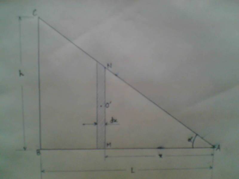

Ok, I am assuming your wedge to be as shown in the attached file. Is it okay?
The wedge is being rotated about rightmost vertex, A.

Wait, I am a bit confused about the figure.
First thing, your wedge is a right-triangular prism, of some thickness, t.
The triangular face has sides L and h. (None of these are hypotenuse of the triangle.)
Now let us consider this triangular face on the plane of the paper (such that thickness, t, is along the perpendicular to the plane of the paper). Call it triangle ABC, right angled at C.
Your axis is passing through one of the vertices, A or B, of this triangle. Say, it is passing through A. Then, AC = L and BC = h.
Now, is your axis perpendicular to the plane of this triangle (i.e., parallel to thickness, t) or, is it in the plane of this triangle (and perpendicular to AC or BC) instead?

Assume thickness of the wedge t. Take a small section of wedge width dx and height h' at a distance x, perpendicular to AC. Now dm = D*h'*dx*t, where D is the density. In triangle h'/x = h/L. Hence h' = x*h/L;
dm = D*(h/L)*t*x*dx.
I = Int{x^2*dm} = D*(h/L)*t*Int{ x^3*dx} from 0 to L. In the answer put 1/2*D*L*h*t=M. Hence find I.
wow I got the answer right away assuming some thickness...
