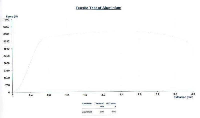

Not quite sure how to calculate 0.2% proof stress of aluminium. The graph for which I need to read is below.

good old Al eh? I guess the initial bit is the settling-in phase of the mechanical tester?
Yes, there definitely appears to be a settling-in regime. The x-intercept of the best fit line to the linear regime could serve as the 0% extension. Having translated the x-axis accordingly, the standard procedure of drawing the parallel with intercept at 0.2% should now work.

There are 2 common reasons for seeing the kind of "toe" that you have in the very beginning of your curve:
1. In porous materials, the initial part of the deformation involves the collapsing of pores and cracks,
2. There is a response lag in the testing machine - this is known as settling in.

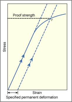

The proof stress is measured by drawing a line parallel to the elastic portion of the stress/strain curve at a specified strain, this strain being a percentage of the original gauge length. In your example 0.2% proof is desired.
Calculate what 0.2% of 25.25 is in mm (5.05mm). Multiply that by the answer to your proportion calculation. Offset a parallel line from your line of best fit by that distance.
Your post above (#4) sounds like the correct approach based on your graph (other than the mathematical error previously pointed out).
Your second graph with the best fit line in the proportional area should now be shifted/offset with the same orientation by the indicated amount. Where ever the new line intersects the graph, draw a horizontal line over to the vertical axis and that will give you the proof stress for 0.2% (or whatever value you used).
I've attached a graphic example.

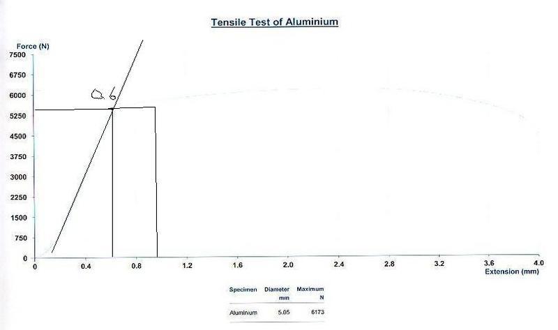

hope i done it correctly, this is the graph i have now
Doesn't look quite right, the shift looks too far. If your measurement was 1mm and the graph's horizontal axis is 4mm in length what is this ratio? It shouldn't be a large shift.
1mm is the measurement, 0.6 mm is where the line of best fit meets, so i calculated 1-0.6 which is 0.4mm and x that by 0.505 mm. That gives me 0.202mm so if i add this to 0.6mm that gives me 0.8mm hence i have drawn a horizontal line and read off the force, is that not correct?
You need to shift the parallel line you had orginally at the point it crosses the horizontal axis by your calculated amount. It's hard to tell from the graph since it is not very clear but the original line appears to cross around 0.1mm. If so, shift it by whatever your distance is, so if your distance is .2mm then just add 0.1 + 0.2 = 0.3mm. That is where your new line will cross the horizontal axis. Which is not where it crosses in your current picture.
when you talk about 0.1mm are you talking about when the line of best fit starts?
and the distance 0.2 mm is that from caculating 0.505 mm by 0.4 mm?
Yes the 0.1mm is where the best fit line appears to start so it will have to be shifted from that point by whatever amount you have calculated.
