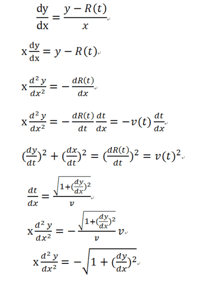

R(t) denotes the position of the rabbit. It works even if either speeds are not constant.
That minus sign is because I forgot to throw a plus/minus in front of the square root.
