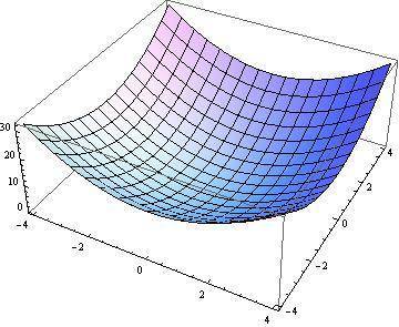

I just started a summer Calculus III course and the introductory topic is graphing in 3-space (just a warning I tend to over think everything). Our assignment was to visualize the graph of
Z = X[tex]^{2}[/tex] + y[tex]^{2}[/tex]​
I plotted points in a table from -3, 3 for both x and y. I visualized this as a topographic table with the Z-values reaching out of my paper. This gives a shape that is similar to a bowl, but the corners stretch upwards (at 18 units) and the center at 0. That's what I drew.
My math teacher and everyone else in the class drew a paraboloid, meaning the top was a flat circle not pointed. The teacher argued that there is a point where all the Z values would be the same and that's what gives the circular shape. I argued that keeping to scale, the shape has corners and that choosing an arbitrary Z-value is creating the picture you want, not the actual graph.

You probably drew something like this:
Your teacher decided to arbitrarily highlight the circular cross-section of the graph, while you decided to draw as much of the graph as you had domain, highlighting the parabolic cross-sections. There is not really any reason to argue against either representation, although your teacher's representation is more native to cylindrical coordinates than Cartesian.

That makes sense, but is there no definitive shape for this graph? Because scales vary, any graph could be manipulated to look like anything. Isn't there standards for this kind of stuff?
And I'm starting to grasp my 3D cross section question. You would have to define which planes were intersecting this shape, for instance Z=1 and Z=3. This would create the frustum shape, but you can have any type of cross section really. I have no idea what my Delta Z shape is though, it sure does look funny.
You can cut the graph off using any shape you want, as different views of the graph will be useful for different objectives. The graph itself does not change, as the points (x, y, z) that satisfy the equation do not change. All you're changing is the location, orientation, and size of your bounding box that looks at some finite region of the graph.
Yea, that's the problem I'm running into I guess. Everyone has different manipulated versions of this graph, but when I try to visualize this graph, I never know how I should picture it. That is the most frustrating. It seems like there is no definitive answer to quench my visual problem, so I should just arbitrarily pick a shape and roll with it.
