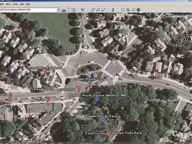

If the traffic circle has more than one lane, the circle is the only shape where the driver does not have to constantly adjust speed and steering angle to stay in his/her lane. By the way, around Cambridge, MA USA, what shape traffic "circle" is used in Harvard Square, Central Square, Kendall Square, Powderhouse Square, etc.?
[Edit] I attach a Google Earth view of Powderhouse Square (actually in Medford). It is neither a Square nor a Circle.

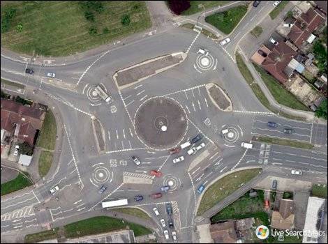

If a traffic circle is a roundabout, it's probably because your American road layout men are lacking in imagination. They're all sorts of shapes over here. There's even one in Hemel Hempstead that you can go round clockwise and anticlockwise.
Or this one in Swindon is almost fractal
