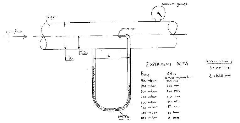

Dear all,
I have a simple experiment to make a cheap pitot tube using 3" PVC pipe to measure vacuum pump air flow. But in the middle of my experiment I have difficulty to calculate air flow in the pipe, because I try to use bernouli equation for standard pitot tube and the result still not same with pump factory refference.
May some body help me?

Is your pitot tube reading high? There may be an entrance loss on your pitot tube that causes the deviatiation from ideal Bernouli flow.
Make sure your pitot tube is well aligned with the inlet air flow. Also, chamfer the inlet with a 30° chamfer. This will help with the probe being less sensitive to yaw errors.

Interesting setup. It will be impossible to help you without seeing your actual calculation. I'm guessing you have a unit wrong somewhere.
The pictures are too small to tell anything.
