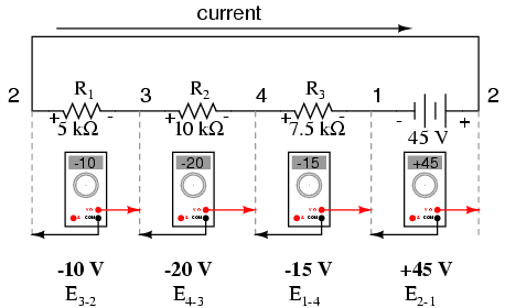

Thanks guys but I'm still at square one. I don't think I expressed my question properly. I understand K.. law.
Why do different resistances get different portions of the voltage. For example in 1--4 do have a voltage you need to have more electrons at 4 than 1. If the current (rate) flowing through each resistor is the same how can there be different electron differences. Basically why do different resistances have different voltage drops?
Voltage is not about the number of electrons. It is about the energy available to move electrons. Outside of the battery electrons are not stored, gained, or lost anywhere in the circuit so the number of electrons passing any point in a time interval must be constant. In other words current is constant in a series circuit.
Now do you know Ohms Law?
E=IR
This gives the voltage measured across a resistor given the current through it.
In a series circuit the current is constant and the sum of the voltage drops is equal to the source voltage.
They get different shares of the Voltage because they need different amounts of energy to shift charge through them. Once the situation has settled down (after 1ns or so) the KII situation will apply. The battery supplies just enough power to drive current through them all and each one dissipates just enough to balance the situation. If you short one of the resistors out, then the PD is shared out amongst the rest, after another ns and KII rules again.
